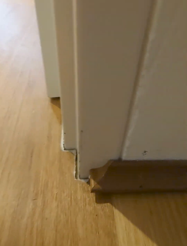

Any ideas how to fix this ? We had our floors changed professionally less than 6 months ago and now this happens.

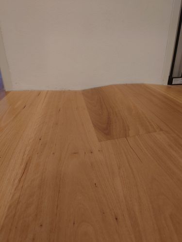

Floating floorboards do contract and expand I know but usually that is hidden by teh edge taht is put around the room. Your seems to be missing that spot? With the second photo is that a crack in the floating floorboard? Or a bow?
Hello @H3nna
I'm definitely in agreement with @Dave-1 on this. I suggest calling the installer and have them repair the bowing of your timber flooring. This phenomenon usually happens when not enough space is placed between the edge of the flooring and the wall. When the temperature changes and the floor begins to expand it takes up that gap.
Failure to provide expansion space for the flooring will result in bowing which is what you are experiencing now. If you are experiencing multiple bows in your flooring it will be necessary to re-lay the timber flooring and a proper expansion gap put in.

Yes they are coming to have a look if there are something they can do. There was the edge but it has since fallen out because the floor boards have expanded and bowed.
Thank you Eric. Originally there was the expansion space around the edge but since the floor has expanded they have now filled out the gaps.
