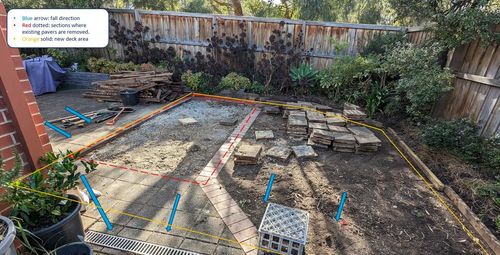

I'm planning to build a deck on pavers. Here are some details (also see photo).
- Deck will be outdoor, uncovered.

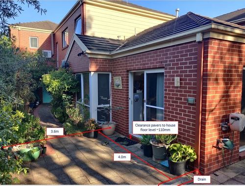

- Size approximately 4.0m x 3.6m
- Thinking of joist spacing ~450mm
- Merbau decking
- Pavers seems stable, however, some areas are uneven.
- Clearance (pavers to house floor level) ~110mm

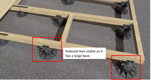

- What footings to use? Is Builders Edge 25-40mm Minifoot Pedestal Feet suitable?
- This should bring the total height: 25 (footing) + 70 (joist) + 19 (deck) = 114mm. Will this cause any issues with ventilation and drainage?
- Will I be better off by building the subframe from scratch (using H3 timber + pedestal feet) OR by using the Good Times module base frame 70x45?
- Can the deck cover the drain?
