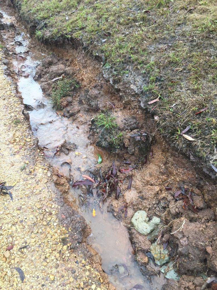

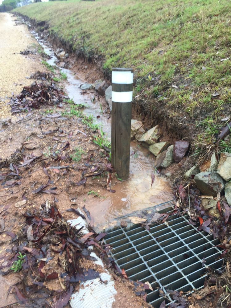

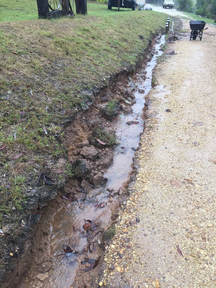

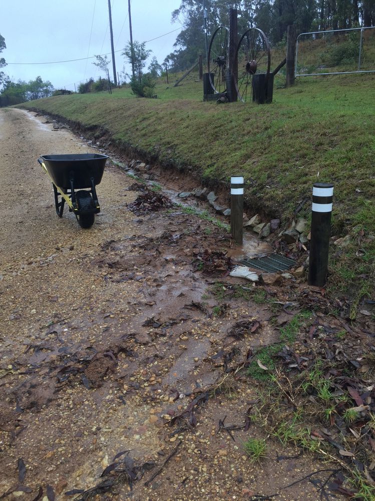

All good now @JacqG! I've added the images to your original post. I'll tag @Jewelleryrescue and @Dave-1 so they've got a better idea of what's going on.
The best option might be to line the trench with geotextile fabric and then fill it with drainage gravel. A bulk delivery hopefully wouldn't set you back too much. Have the truck dump it's load along the length of the trench and push it straight into the ditch. The only other option I can think of would be running a retaining wall along the entire length, but that's quite a long distance and a considerable amount of work.

Wooohooo 🙂 Drainage plus! I like your gutter and would still go for the gravel/ag pipe with a sleeve and then more gravel tho maybe a larger size to cover it.
One of my workmates suggested larger stones to form a kind of dishdrain/creek bed. That could look pretty stylish and would also carry your excess stormwater. He suggested some quickset concrete in it but I am not sold on that idea 🙂
One of the photos have a line of small stones along the edge, Thats the size I wa sthinking for a dish like drain, maybe larger sized rocks on the high side of the gutter.

Thanks for sending the photos. Now that we see what's happening have you considered creating a concrete channel such as a spoon drain? It is possible to do it in 1m sections so that it will not crack or split. Another option is to use Brighton Masonry 200 x 200 x 50mm Charcoal Mypave Paver and build a "U" shaped channel to direct the water to the drain. The pavers can be joined together using Selleys 320g Liquid Nails Original Construction Adhesive.
wow so many great ideas and options..I guess I want to be able to do it as cheaply and effectively as possible. Am liking the brick rubble with mesh to geo.. Everyone has been really helpful!
