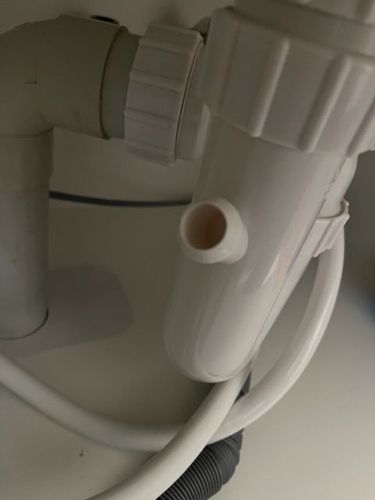

I wanna ask if I want to install the drain hose under the sink. And there is no position for me to install? Do I need to ask the licensed plumber to do it?

Take your photo and a measurment of your pipe diameter and ask at Bunnings
There are so many plumbing fittings which can be a nightmare and adapters you should never have to drill the fittings though as it then opens the possibilities for hard to seal leaks.
1 minute.
Are you saying that Y connector sticking with the push on hose connection has plastic flap sealing it on the inside diameter to the main drain?
If it is drill it and add a push on hose with hose clamp.
Thank you so much for your answer. I will try to ask the staff in Bunning to see any good options for that. But am I not supposed to change anything for the plumbing if I am not a licensed plumber?
Technically you are correct any house hold plumbing should be by plumber.
Having said that a lot of people do minor connections themselves to guide you watch you tubes made by real plumbers and see if you have the confidence to under take the task. Many plumbers dont like the small pesky jobs and will charge a fortune as I recently experianced in sydney .
But decent plumbers still exist out there to there credit and good morals I feed them as much work as I can
Worst case scenario if the plumbing leaks is you will have to call a plumber.
Another thing I do is when I call a plumber is line up several fixes so they all done in one call out.
Hello @Vincent28
It's great that you've received excellent advice from @Jewelleryrescue. If you do not have the necessary tools or have not done any plumbing works, I suggest engaging the services of a registered plumber. In this manner the connection will be under warranty.
But if you are curious about the steps, the general procedure is to drill into the drain spout and connect your drain hose into it. It is then held secure by putting a hose clamp onto the hose itself. Please note that any mistake in drilling could damage the undersink trap which will cause it to leak. You'll then have no choice but to replace the entire set.
