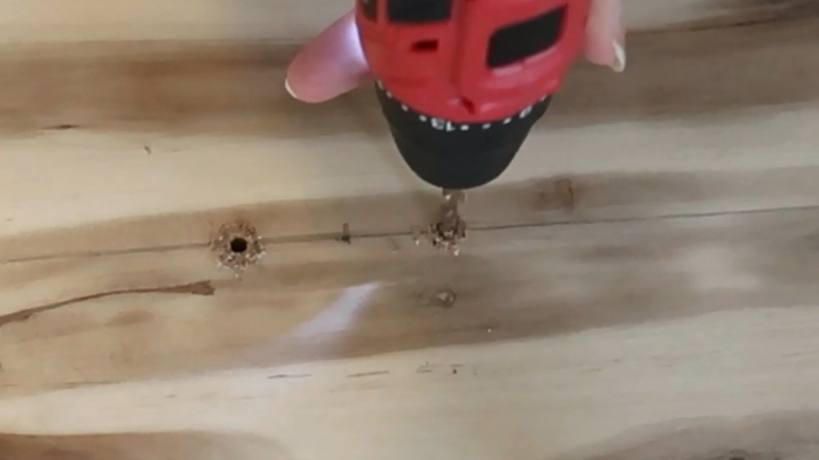

Originally, I was going to sand all four drawers, but I changed my mind. The first step was to measure, position and drill the hardware holes.
Measuring and positioning hardware holes was the first step.
Drilling into the timber before it's painted means I don't have to worry about potential mistakes in positioning.

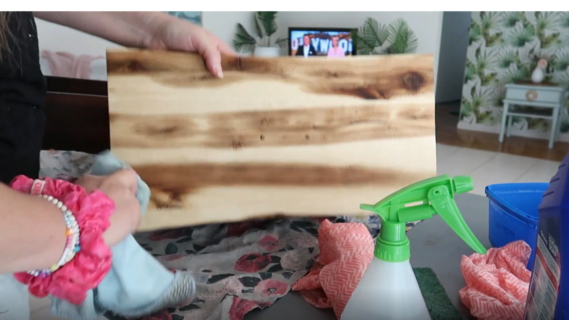

Using my trusty to sugarsoap to thoroughly clean the drawers. I spray with water to wash any residue off.
Using sugar soap removes dirt and residue.

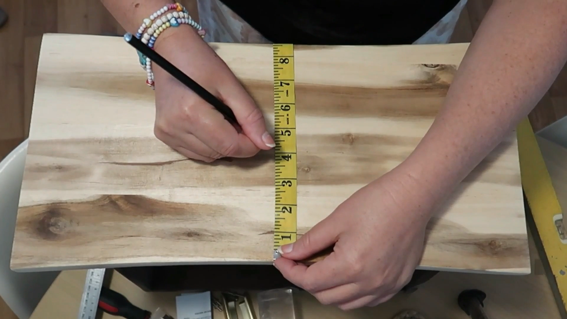

I wanted the textured wallpaper on the sides of both of the drawers and also on the front of the drawers so I measured the panels and cut to size.
Textured wallpaper for my bedsides.
Measuring and cutting the wallpaper for the panels.

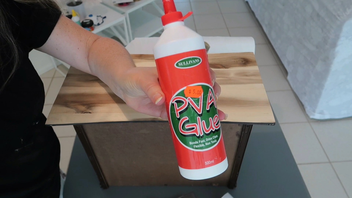

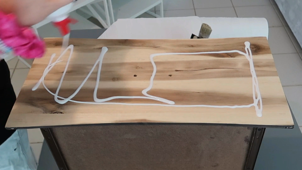

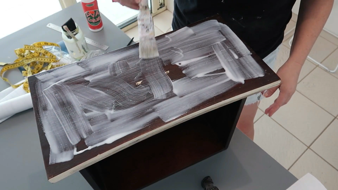

I used PVA glue to apply the pieces to the drawers and sides of the tables. It was important to wipe over the paper and smooth out making sure there were no air bubbles or creases. When applying the glue, I made sure the panel was covered carefully to the very edges to prevent future peeling.
PVA glue works great when applying the textured vinyl to the panels.
Applying liberally.
Making sure the glue is spread to cover the entire panel.

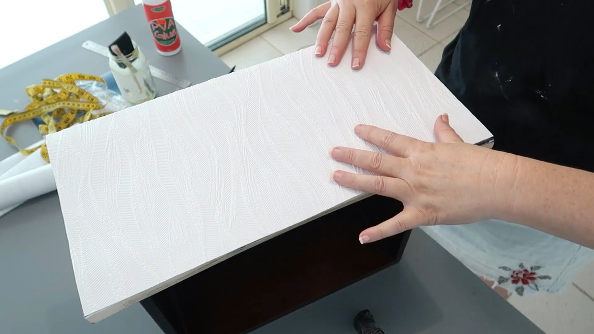

I took my time making sure the wallpaper was properly adhered .
I also covered the sides.
On bigger wallpaper pieces I tend to stick from the top and slowly stick and smooth down as I go towards the base.

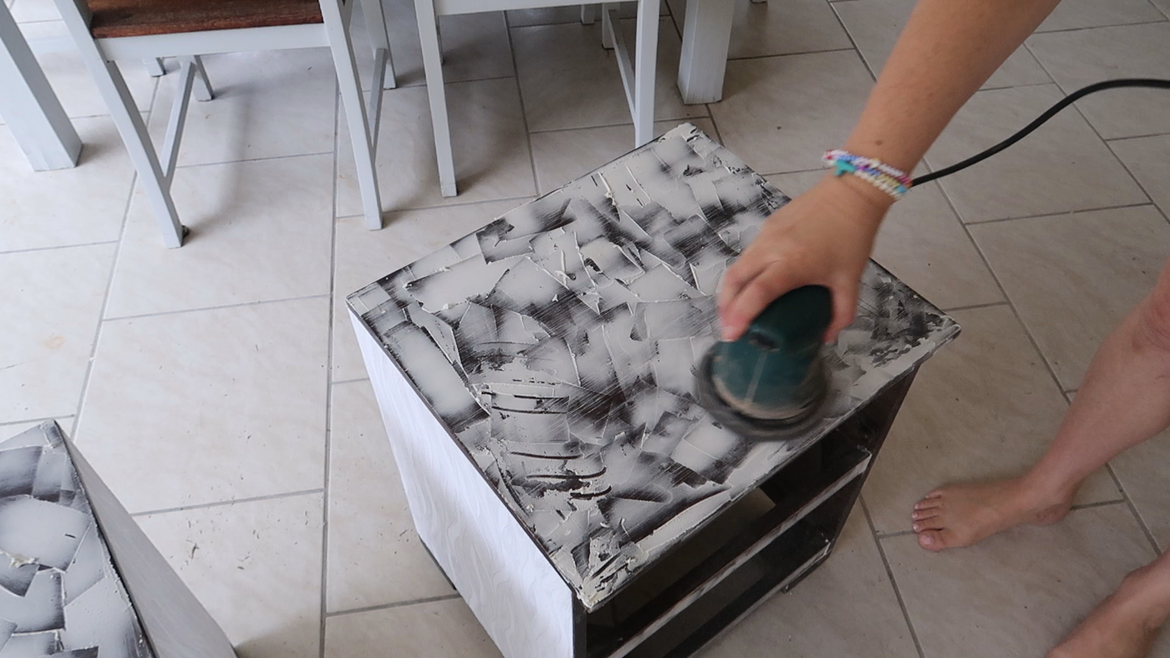

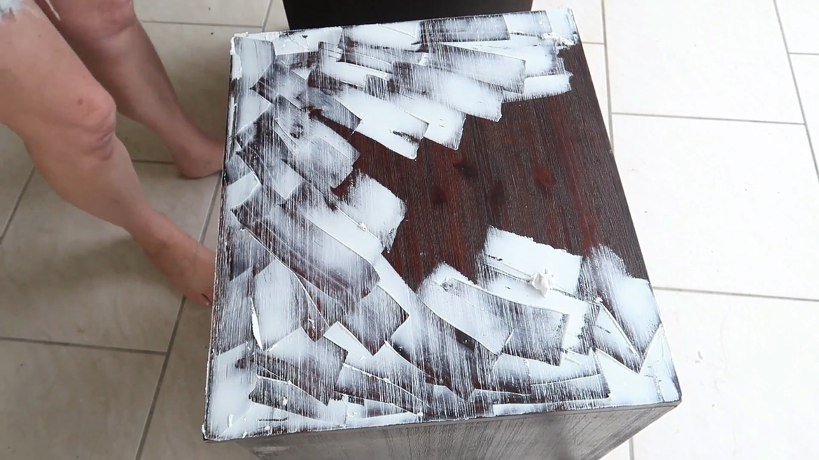

I had to use wood filler to fill some holes at the top but went berserk and applyed it to the whole panel. The idea behind this was to fill in the grooves in the timber and make it one smooth panel. I wouldn't do this again I don't think because I had to sand back extremely hard, exposing the timber. This created a problem with tanin bleed through when I painted.
Covering the top with wood filler.
It took ages to sand this back, this filler is amazing and can be used for indoor and outdoor projects.

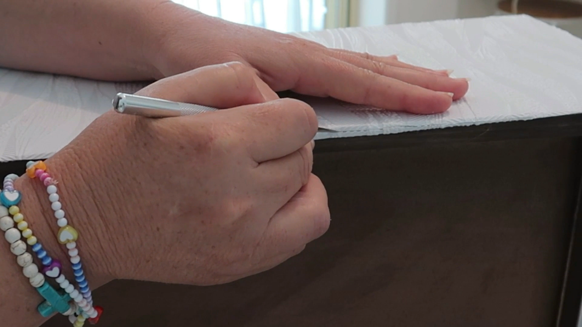

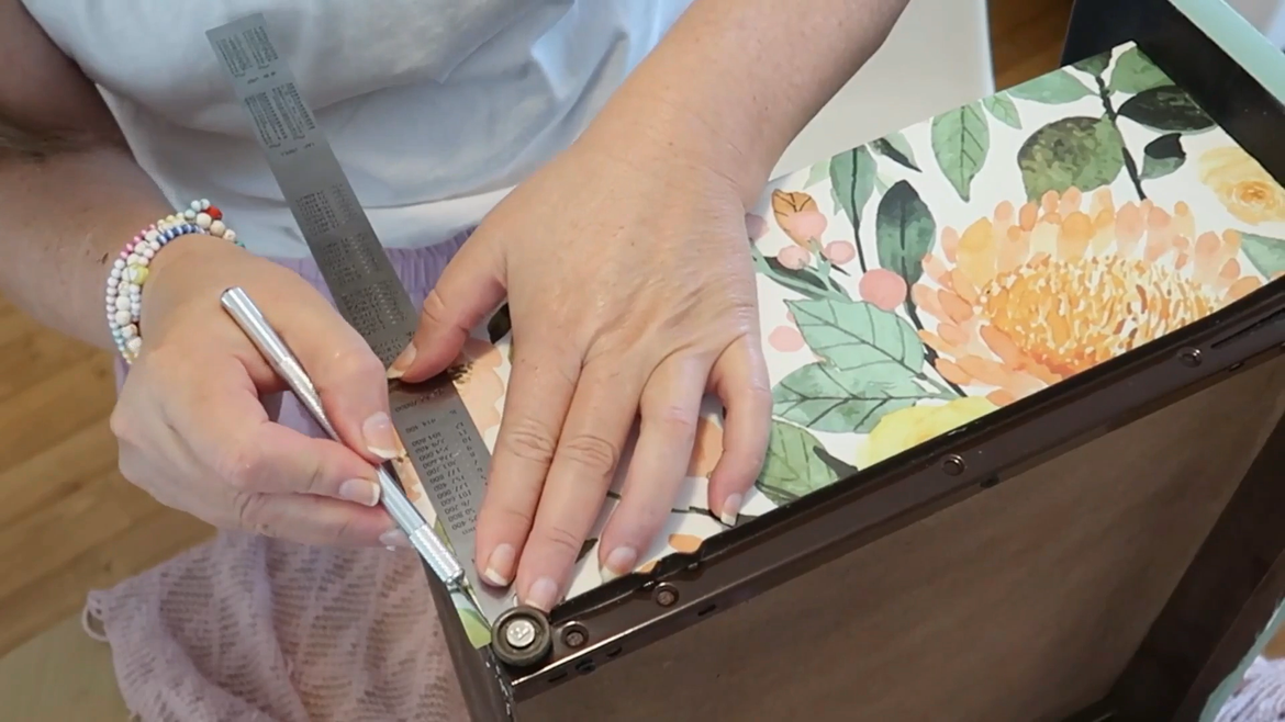

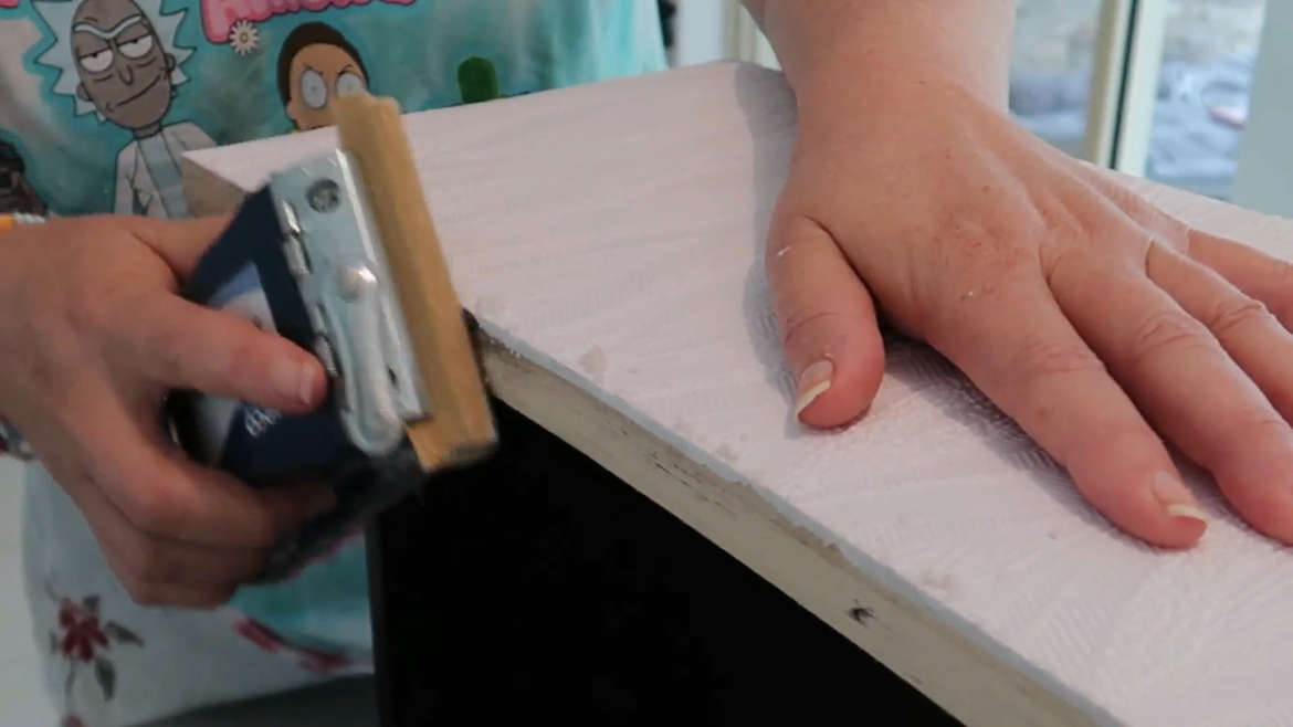

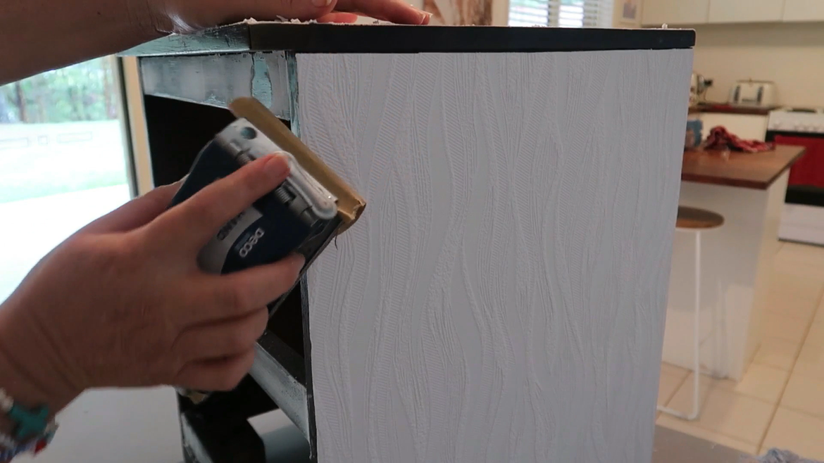

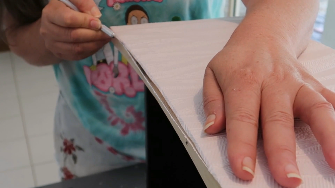

I did the leave the glued wallpaper to dry overnight as I always sand the edges so that they appear seamless and blend into the timber. It needs to be completely dry and hard so there is no danger of the paper tearing. As these drawers were shaped I decided to slice off some of the paper just so it was easier to remove any paper hanging over the edge. I don't wrap my paper around the drawers, I just place it on the front hence the need for the sanding and smoothing steps.
Taking off excess paper.
This step makes it a bit quicker to sand the overhang.
Sanding down so it is seamless and smooth is so satisfying:)
Also sanding the edges of the sides.

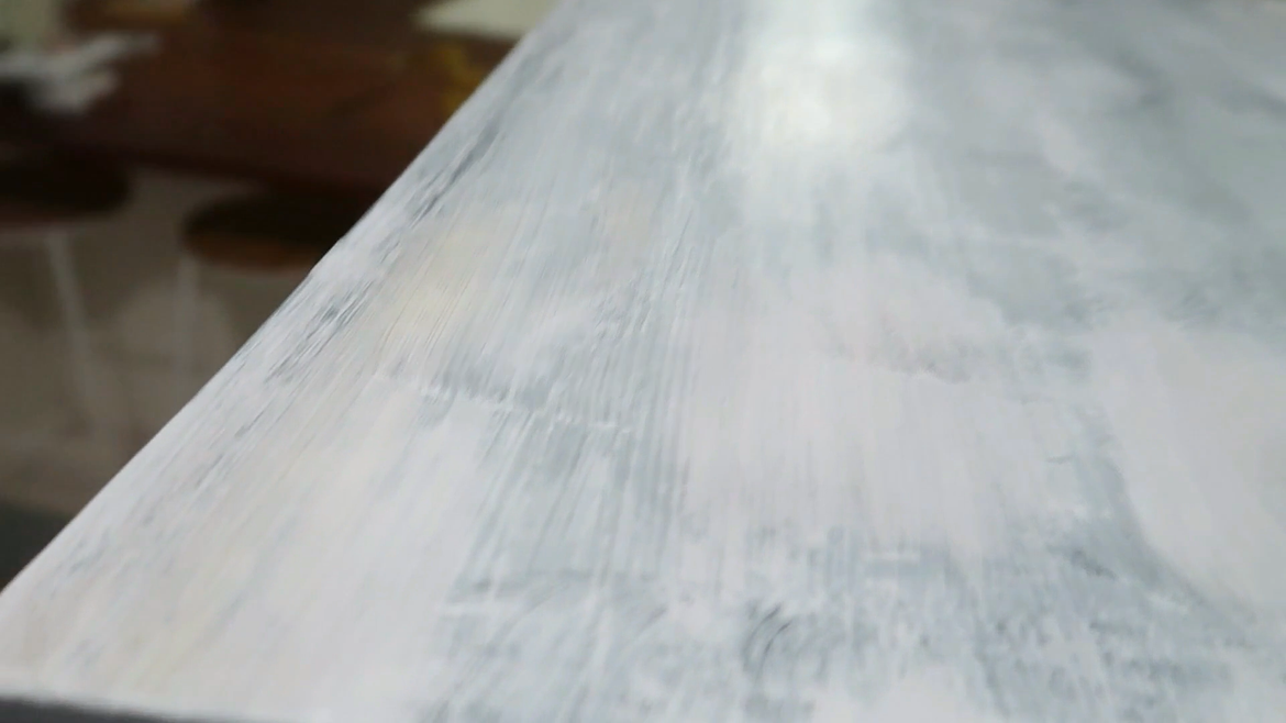

I make my own chalk paint and normally use talcum powder but all baby powder now is using cornstarch which doesn't work as well. Calcium carbonate can also be added to the paint to make chalk paint so I bought some of this and added it to my paint. I buy mistint paint pots for $2. The great thing about this is the price but also I come across colors I wouldn't think of using myself but are so beautiful!
Calcium carbonate to make chalk paint.
These little mistint paint pots will just do two bedside tables.
Adding the calcium carbonate to the paint.

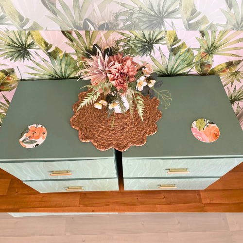

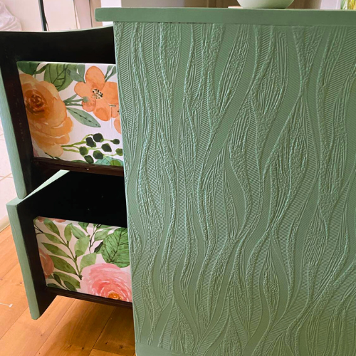

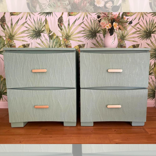

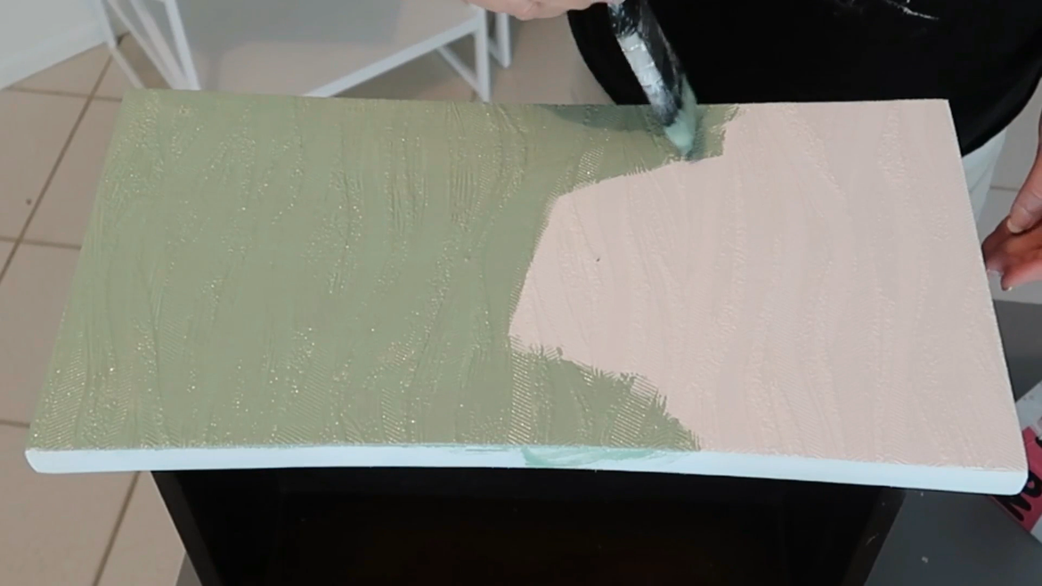

I used two coats of paint in total but had to put three on the top as when I sanded it, it went screaky. I applied some pretty wallpaper to the sides, applied the handles and floor protectors, waxed for protection and made some cute little coasters that I always sell with my pieces. The result was so pretty and such a stretch from where I started!
Applying the chalk paint.
I ended up painting three coats on the top.
Pretty wallpaper looked lovely on the drawer sides.

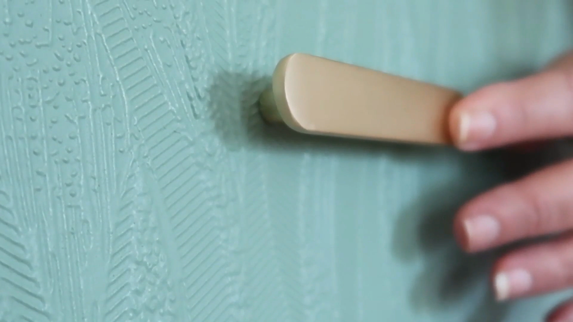

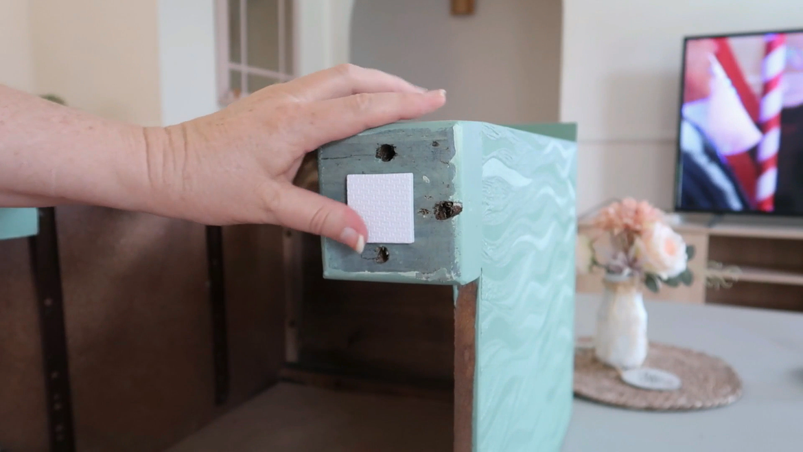

No stress applying beautiful gold metal handles in predrilled holes.
Floor protectors a must.
I always wax which gives the paint a lovely matte sheen.

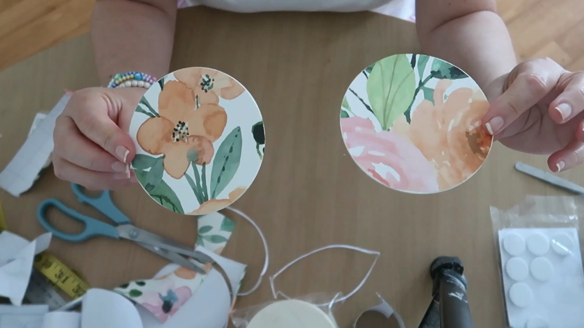

Lil coasters using craft coasters and wallpaper
I love the end piece...so pretty.
