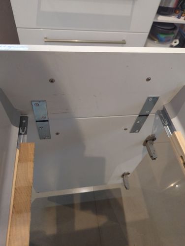

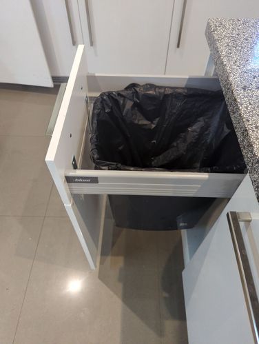

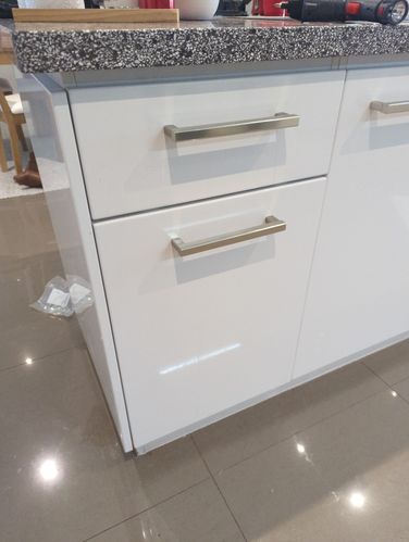

I've converted a kitchen draw and cupboard into a under bin holder. I used brackets I had lying around to connect the draw and the cupboard front, but the cupboard door wobbles alot. I think the brackets I used are too short, but wanted to check if longer brackets or a wood plate would be better to fix this?
I've also considered using draw slides for the bottom so stabilise, but really trying to keep with cheap and simple.
