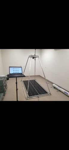

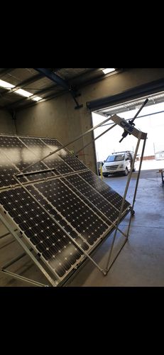

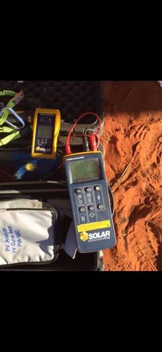

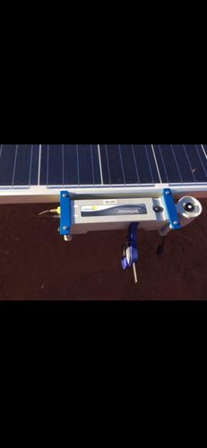

My last business development and previous company was Solar Panel Analysis for onsite installations which involved IR topography Land and Drone, IV curve measurements, Gloss Meter measurements, Electrolumenescence (xray images of panels), experiments laser measurement, and a whole other array of measurements. So trust me when I say you don't want to do this you really don't.
Panels are fragile, they need airflow as they get extremely hot and they are producing electricity. If in doubt contact the panel manufacturer for advice, don't risk your investment or worse your house.
