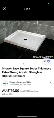

I have a shower base from elegant showers and im wanting to have 1 shower screen (800mm) on one side. Is that possible?I’ve seen you can’t have a frameless shower screen on this base? Thanks Diana
Welcome to the Bunnings Workshop community @dianaavery. It's marvellous to have you join us, and many thanks for your question about shower screens.Our frameless panel screens, like the Mondella 10 x 2000 x 875mm Glass Frameless Shower Panel, are designed to be installed onto tiles and not a preformed base as you have. The semi-frameless versions are typically suitable for these bases, and it might be best to discuss what options would suit with the base manufacturer. The semi-frameless screen you choose needs to sit on top of the recessed perimeter inside the top lip. Looking at our semi-framless screens, it appears their footprint, although adjustable, would not fit a 1000x800mm base.
If you can't find a screen to suit that base, we have various shower bases to suit our screens.Please let me know if you have any questions.Mitchell
