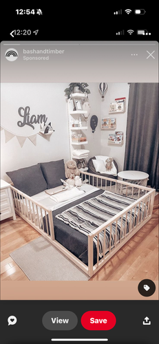

Welcome to the Bunnings Workshop community @lidy16. It's wonderful to have you join us, and many thanks for your question about constructing a bed frame.
It appears the majority of the froma is made from 42 x 42mm DAR Pine, and the dowels look to be around 12mm. It's best to break the project into sections so you can better understand how it's constructed. I've put a couple of renderings together for you below that should hopefully assist.
You'll begin by determining the frame's dimensions to suit your mattress. Then, cut the 42mm timber for the horizontal and vertical rails. Those will need 12.5mm holes drilled in them to accommodate the dowels. The dowels get inserted, and then the rails screwed together. The four sections can then be joined to create the frame. I'd suggest 60mm timber screws would be an appropriate choice for the projects.Please let me know if you have any questions.Mitchell

Hello,
Do you know which material they use to make this bed?
Thank you in advance!
Welcome to the Bunnings Workshop community @father1. It's sensational to have you join us, and many thanks for your question on building a bed.
By the looks of it, it appears to be some type of hardwood, possibly similar to Tasmanian Oak. We also have it available in dowel to make the uprights.
Please let us know if you have further questions or need assistance with your project.
