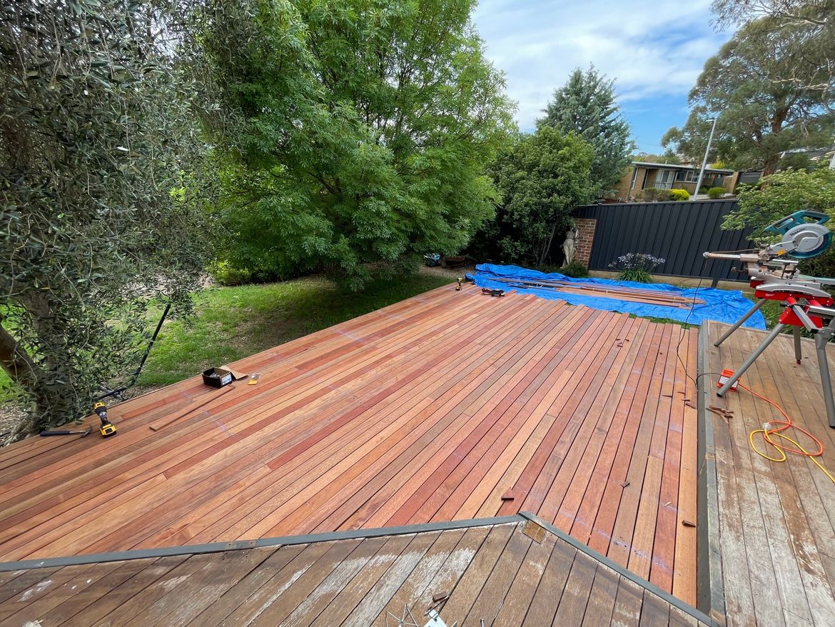

I'm just finishing up a low level deck extension (Please ignore the tired older deck in the photos, I will be coming back to fix that up once the new part is done)
So in my mind everything is built to code and technically exceeds it I believe but I have a question regarding some spring/bounce in the deck now that I have laid the decking. Please note, I have yet to completely finish screwing the boards down. In most cases there is only a single screw per board per joist and in some cases, every second joist may have no screws just yet for that run of board. So I do wonder if completing the screwing will tighten it all up further, but thought I should ask at this point anyway.

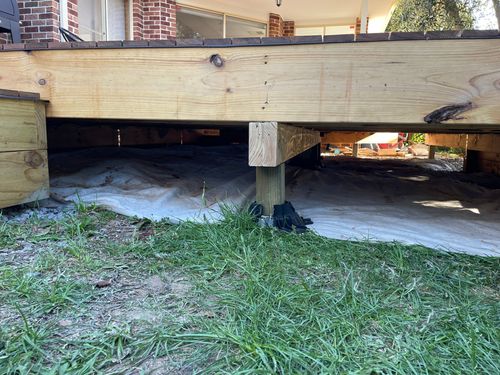

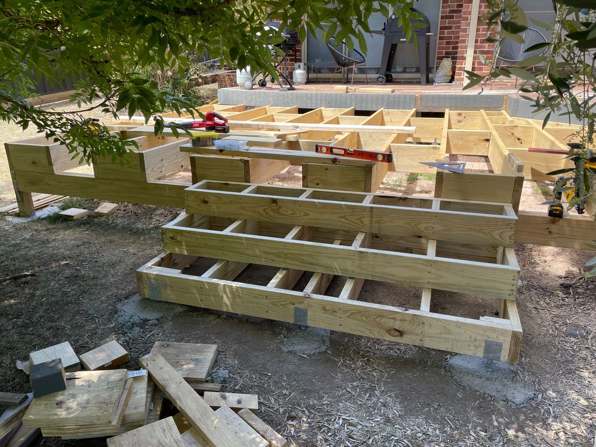

Now I did purposely maximise my spans as much as possible. I chose to spend more on material than digging holes - my least favourite part lol. So there 3 bearers, one front, back and on the 45 degree.
The new part of the deck is completely independent to the old deck.

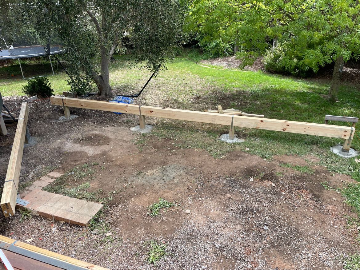

Longest side has 4 posts at ~1950 centres
Back side has the same with a shorter spacing on the inside post closest to the centre of the old deck.

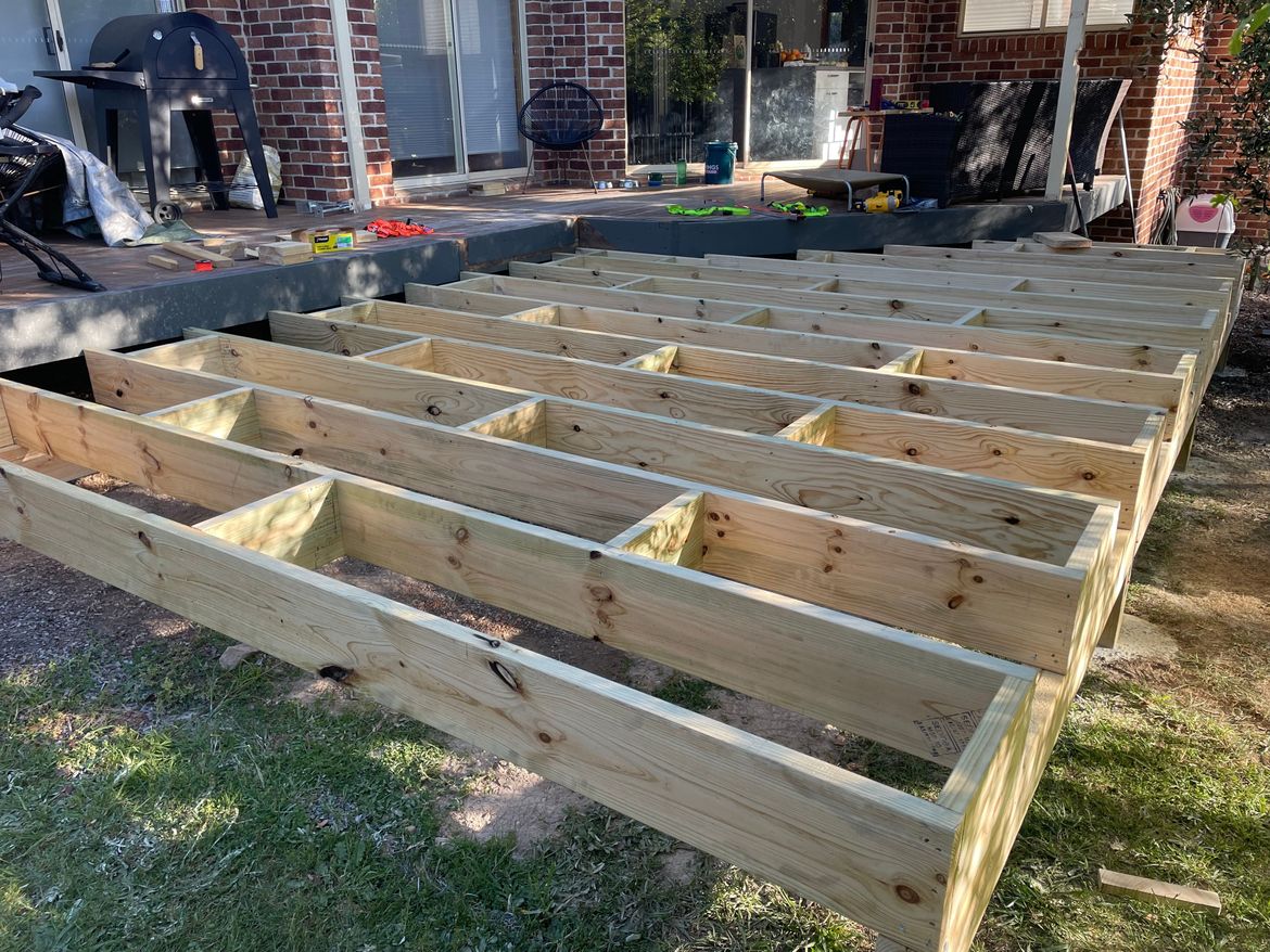

45 degree has a wider centre between posts (there are only two) but is still to code and is carrying a shorter joist span. (Note that the cantilever on this bearer is actually only a 3rd of what you see in the photo as it's now been trimmed to be square with the front bearer)
Bearers are 2/190x45
Joists are 240x45 at 450 centres
The whole subframe was nailed with a framing nailer. Deck is being screwed down.
So yeah, is a little spring/bounce completely normal and expected? The span for the joists is quite big, but less than the maximum span for 240x45 and when I stood on the centre of a single joist before putting a deck on, I didn't notice any flex at all. It's only now with the decking on that I am feeling it.
