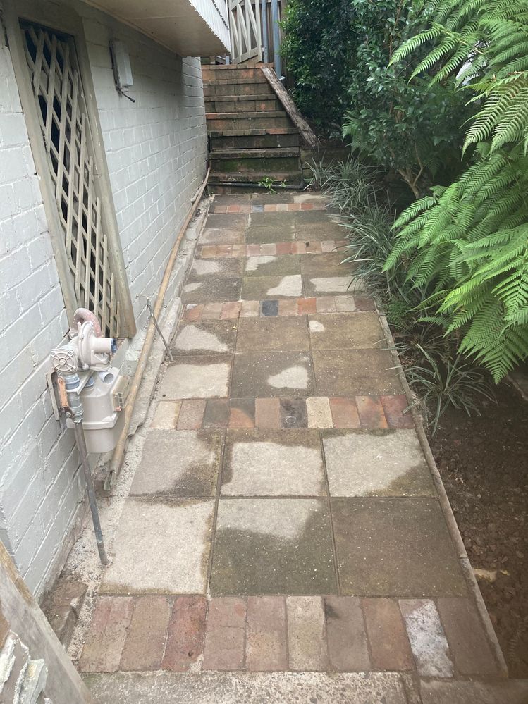

I want to share with you how I redid the paving of the sidewalk next to our house. The previous paving was loose in parts and very slippery in wet weather, so I decided to replace it.
To keep costs down, I reused concrete pavers that were left over from a patio upgrade and used bricks recycled from a demolition. I also used sand left over from the patio project. I only bought a tonne of road base and three bags of mortar.

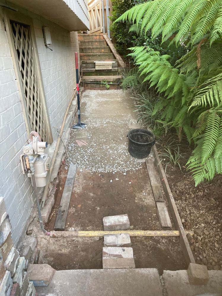

Lay base layer of road base
Since the bricks and pavers were of different height, I first laid the road base at the height of the thicker material, the bricks. As you can see from the photo below, I used timber on both sides to control the height of the layer. I then compacted the layer with a hand tamper.

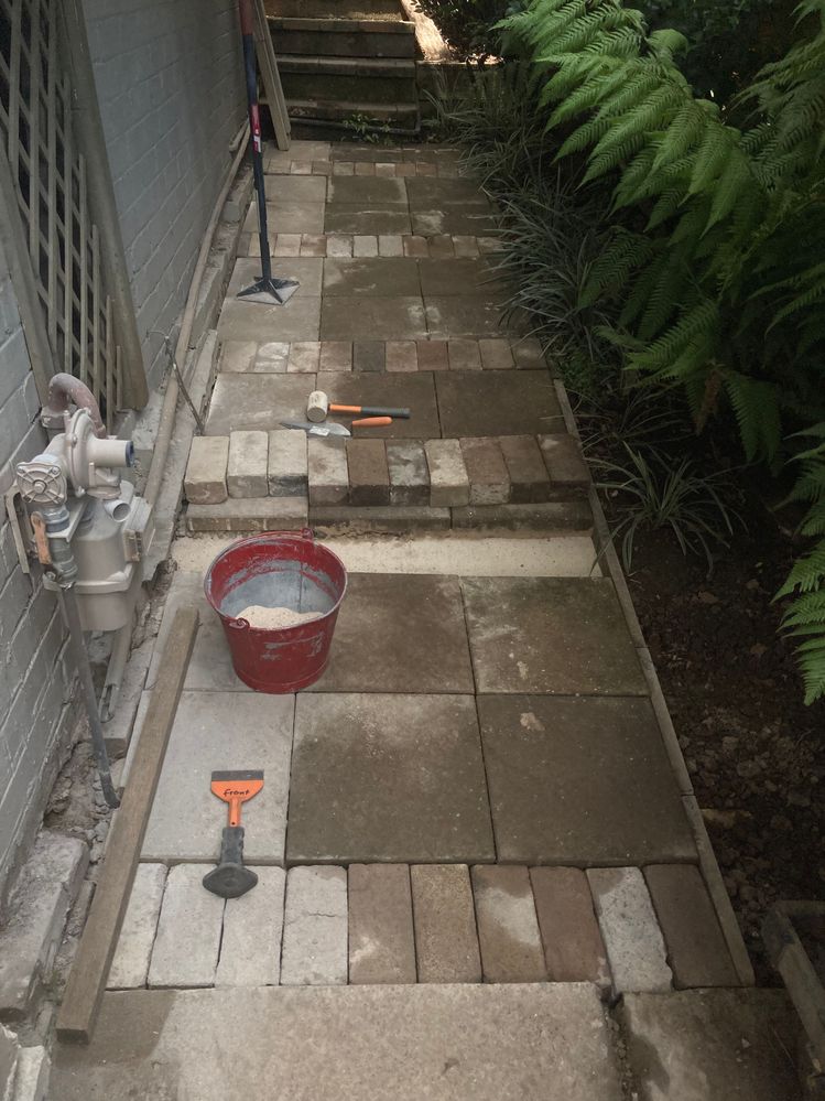

Lay pavers and bricks
I laid both materials so I could execute the next steps for only the pavers, since they needed additional road base. This enabled me to know where they would be situated and not have to move them later. During this step, I found out that some bricks were shorter than others, which enabled me to select the shorter ones and make a single line of concrete pavers to fit exactly at the end of the path.
Provisionary laying of pavers and bricks.

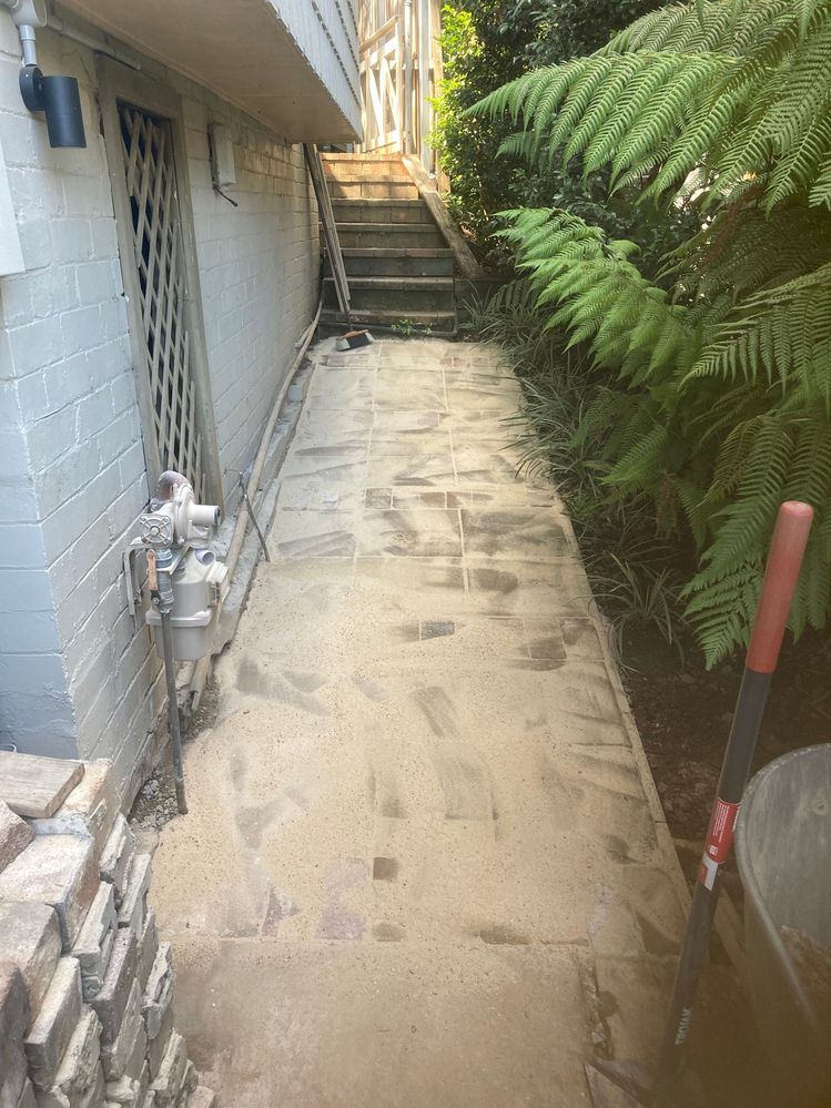

Add sand layer
Now I added the layer of sand to the area of the pavers. Since I only had a limited amount of leftover sand, I only added 10mm. To screed such a small height, I found two lengths of reinforcing bar (10mm diameter) worked perfectly as guides.

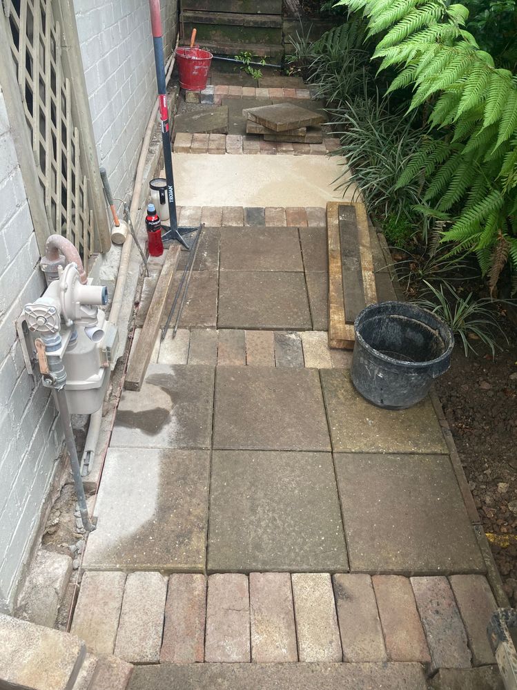

Lay pavers
Then I laid the concrete pavers and cut to size where needed.

Lay bricks
Now I could lay the bricks and ensure they lined up with the pavers.
