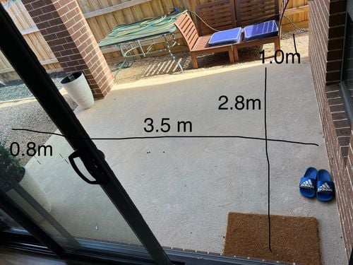

I am planning a DIY deck for area 4300mm (3500mm concrete + 800mm pebbles) * 3800mm (2800mm concrete + 1000mm pebbles) and height is about 155mm. Apologies for bad photo and edits.

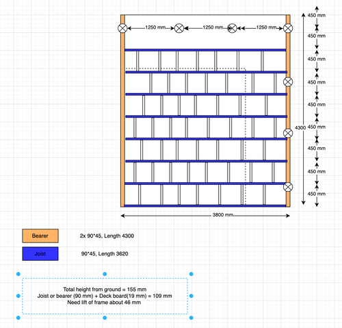

I have also made decking timber frame blue prints on draw.io.
I need advices on below:
1. How should i lift the whole frame for a height of 46 mm?
2. what should i use for the pebbles to hold the frame (concrete post or just concrete pavers)?
3. would love to get feedback on timber frame blueprints
