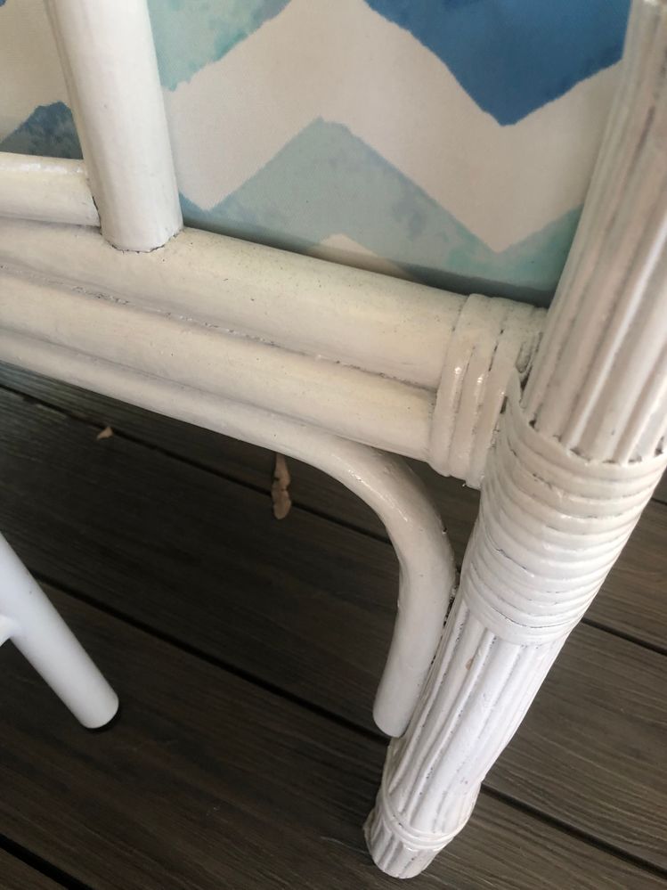

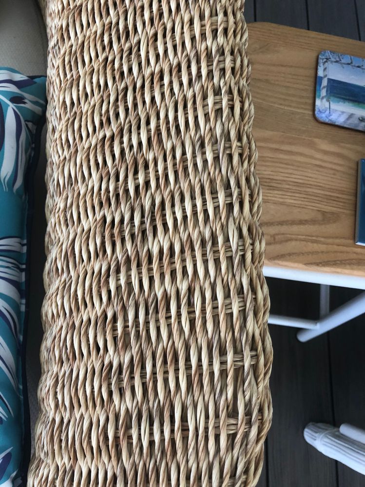

Apologies for the slow reply. Can I please confirm that the first, second and last photos is the white piece of furniture that you want to repaint to make it look like the third image? If so, I suspect that won't be possible given the wicker is not a uniform colour.

Thank you for your reply, yes you are correct re the white to be painted similar to the wicker. I will play around with a mix of dark and light colours and see how it goes. Else I will pick a solid colour that will blend in. Cheers Sue

If you are planning on painting your wicker sofa with that brown and white pattern it will possibly take some time as there is no single brush that can duplicate the pattern in one go. The twisted rope pattern must be painted individually on each strip of the white chair to duplicate the effect. It's not impossible, but it will take a great deal of time.
If you decide to paint the chair instead, I suggest having a look at this discussion - How to paint cane furniture by @Diy_Shell. The general steps are to sand the surface of the chair, clean and prime the surface. Once the primer is dry you can then paint it with a topcoat of your choice.
