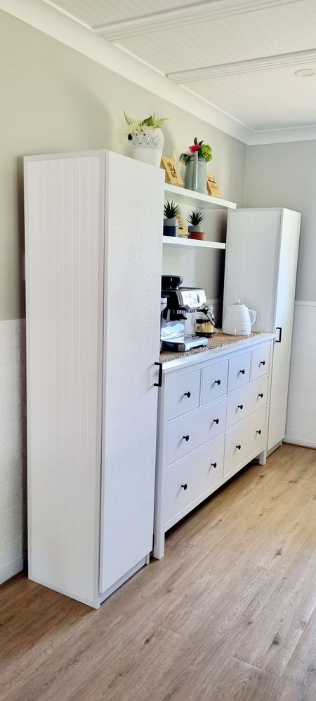

I purchased these Melamine cabinets from Bunnings to use as pantry cabinets for a coffee station in the kitchen. I wasn't happy with how they had no character, so I made them into something more classy.

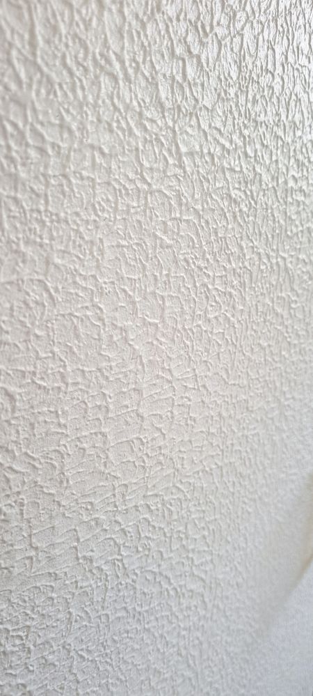

Apply plaster paste to entire door and smooth out.
Step 4

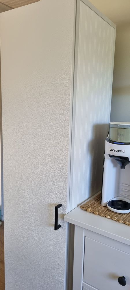

Use a texture roller to create a pattern. The roller I used is an old roller I already had in my shed. I can't remember where I bought it from, it was so long ago. But I think any texture roller would work.
Step 5
Once dry, stand plaster until smooth and paint with top coat.
Step 6

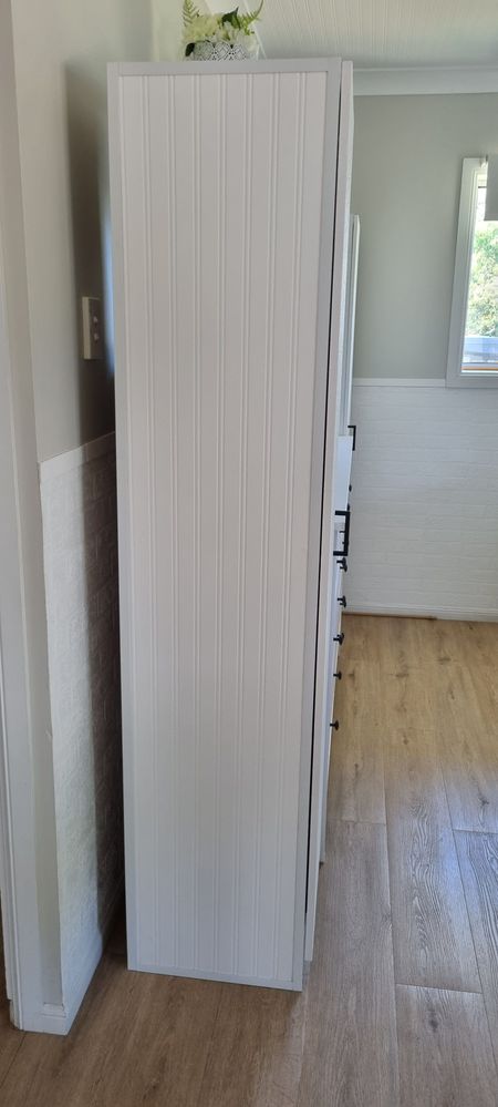

For the sides of the cabinets, I used a paintable wallpaper that was embossed. Prime the sides with undercoat of paint and apply wallpaper, then paint with topcoat.
Step 7
Add PVC trim to the sides of the cabinets to prevent the wallpaper from coming off.
