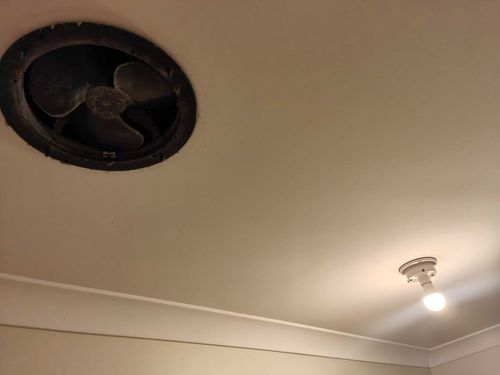

Hi brain trust,
Would you suggest replacement or repair ?
Thank you for any advice
Hi @ivanptr,
Judging by the age of the fan (black plastic from the 1980's), I would probably suggest you have an Electrician look at that.
While the fan is being replaced, make sure that the fan is in fact ducted outside and not merely into the roof space above it,
this can have moisture issues during winter, if it isn't ducted outside.
Your Electrician should be able to sort you out.
BTW, this is not a DIY job, it will more than likely be a 230V fan, 24 Volt fans didn't show up in houses until the late 1990's.
Cheers,
Mike T.
Hello @ivanptr
I suggest getting a new fan so that you will have a new warranty. Even if you have it repaired it is an old fan and other parts of the fan might begin to fail. I recommend measuring the size of the cut out in the ceiling before going to the store and getting a replacement.
Please make sure to engage the services of a registered electrician. Please do not attempt to change the fan yourself.
Hello @ivanptr considering there will be years of use on that electric motor it makes sense to fit a new one (and get years of reliable service), you will note that the replacement units come fitted with a mains rated 3 pin plug, this allows for easy installation (if a mains socket/lead is already installed in the roof space) however if hard wiring into the house is required it should be completed by a qualified person.
If you opt to go for a larger fan the template included (with the replacement) will make enlarging the existing opening so much easier, personally I would choose a unit with a draft stopper that only opens when the fan is in operation.
https://www.bunnings.com.au/diy-advice/home-improvement/lighting-electrical/how-to-install-an-exhaust-fan
The Building Code of Australia (BCA) requirement related to the release of exhaust air to the environment for residential and commercial buildings states explicitly:
It's interesting to note that the BCA also requires a ventilation rate of 25L/s as a minimum standard for bathrooms
