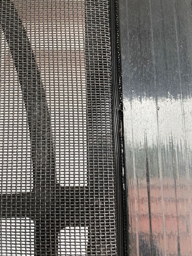

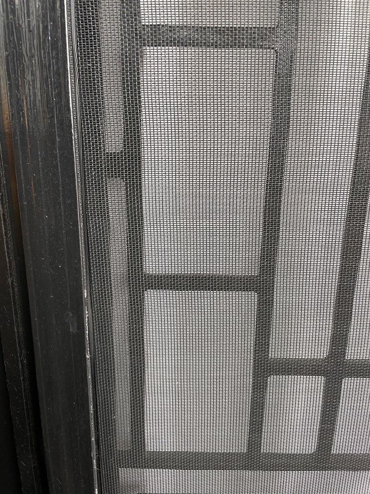

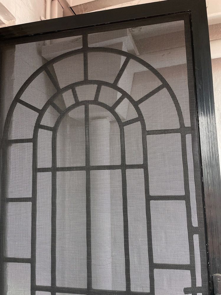

We've turned a bedroom in to an office. It has a Juliet balcony that faces south. The current flyscreen on the balcony door lets in very little light. What is the best flyscreen to let in lots of light? I'm in Sydney's Inner West so not coastal.

My immediate thought about your question is to wonder whether you actually have a door with tough security mesh rather than flyscreen. Could we please trouble you for some photos of the door so we can see what you are working with and suggest the best next steps? Please let us know if you need a hand uploading some images.

Afternoon @jm0227
That looks like an aluminium fly screen mesh. I have just used it on my screen door and I chose the aluminum one as it helps stop embers from melting the plastic version.
Theres a firbreglass version that is stronger then the straight plastic one.
If I had to offer a suggestion of which one to let in most light id probarly suggest the plastic one followed by the fibreglass one as they are finer then the aluminium one.
Hello @jm0227
My apologies for the late reply. It's great that you've received excellent advice from @Dave-1. I believe the thickest one in the set is the pet mesh screen. If you see this printed in front of the packet this will let the least amount of light in. The Syneco 1220mm x 2.05m Fibreglass Insect Screen is the one I have installed in my home, and it lets a lot of light in.
However, I suggest going to your local store and having a look at the flyscreen display board. There you'll see all the various flyscreens on show. You'll be able to tell which one is the thinnest based on your ability to see through it.
