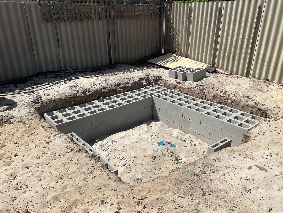

Hi, we are building a sunken seating area in our backyard. We have masonry bricks to do the seat and walls. We want to fill the holes rather than mortar them together. What concrete mix should we use?

Hello @chloel interesting project, I'm curious what the blocks are resting on gravel, soil, sand or concrete?
I agree with @EricL 100% regarding the use of concrete for structural integrity, the surrounding earth may be fine but it is in essence a mini retaining wall and would need to resist any future potential soil expansion/movement, how is the drainage on your property?

we concreted a little trench so the blocks have a solid base
Afternoon @chloel
Your yard seems to be mostly clay and like @DIYGnome I was wondering where the water will go? I have a gabion wall next to a clay area that I dug out and havnt had it shift since so not really concerned about it moving. You could always put a pit (even a solid bucket with holes in the base plus a little gravel and have a sump pump put in if its a concern tho.
Id prefer maybe some of the holes filled with the concrete that @EricL mentions and then the alternate holes filled with that left over sand, that way it will lock the bessa blocks into place and they wont want to move as easily.
Lastly with the narrow wall closest to the photographer, id definitely be putting concrete in all of them and maybe some reo bars as well. Do you have a concrete footing under that side as well? If you are concerned about using concrete and having to pull it out one day maybe make that thin wall one of the bessa blocks thick and fill the same way with the concrete every second hole? I know I look for alternate ways of securing things instead of concrete but sometimes its wiser to use it.

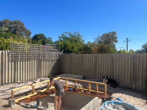

Going well so far. Taking its time. Hopefully the decking is done today!
