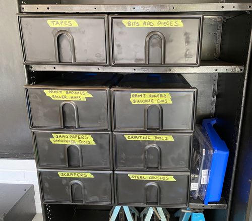

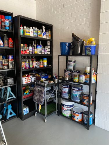

Good afternoon Workshop Community Friends. I didn’t want to get rid of the two metal cabinets we have been using in our Shed. But I certainly didn’t want to put them back in as they were……. Worn, rusted and looking crappy. They are still in good condition to use, just needed a freshen up. I’m more than happy to reuse these bad boys. Better now 😃 I’m always inspired by other fantastic recycled projects on the Workshop, I hope you will be inspired too !!!!

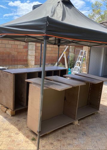

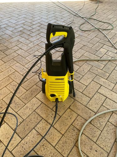

So here we go. I used the high pressure spray to remove the heavy dust buildup, flaked debris ect .

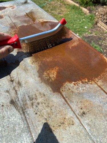

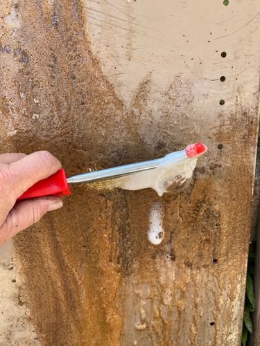

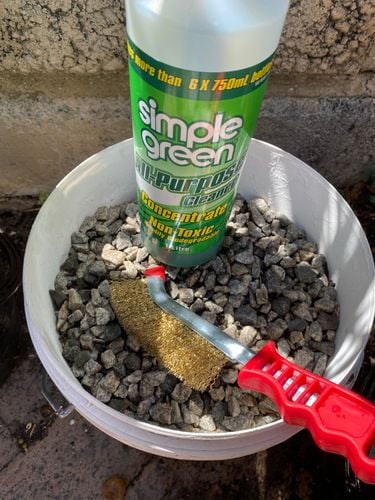

Scrubbed them with a steel brush and Simple Green Concentrate.
Step 2

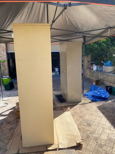

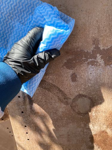

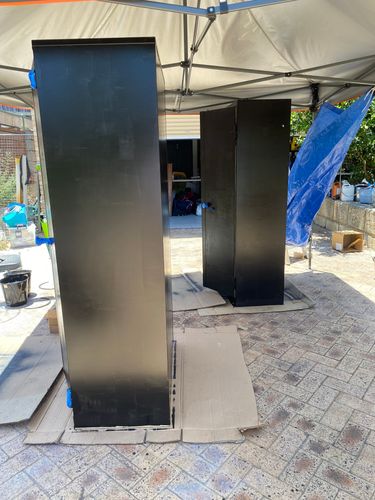

Then wiped them down with Turps. Let them dry completely. It’s really hot here in Perth so I put the Gazebo to work under the shade. Also I did this early in the morning before it got way too hot.

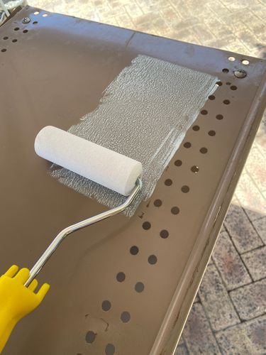

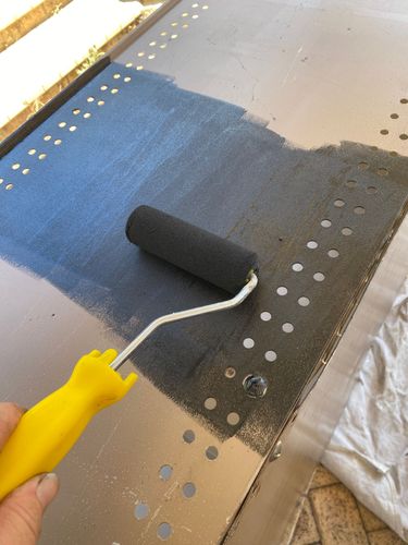

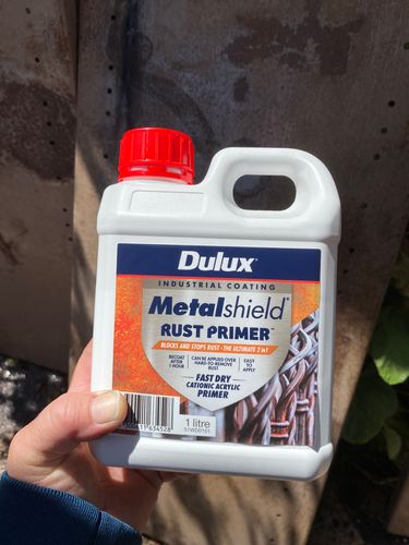

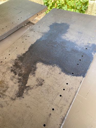

I was advised to use the Dulux Metal Shield Rust Primer. Gave them a full coverage coat and the rusted areas a second coat. Love watching the red rust turn to black.
Step 4

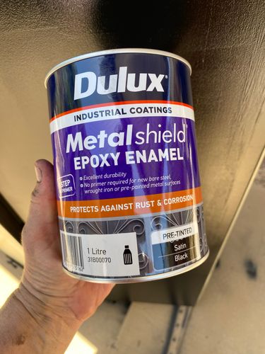

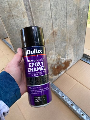

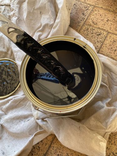

I was advised to use the Dulux Metal Shield Rust Defence paint. I know you may ask why not spray paint ? I’ve never done it before and I like roller and brush !!

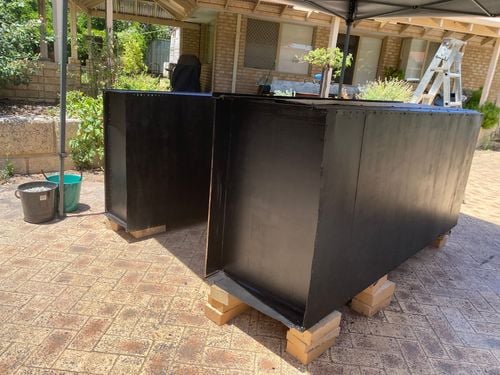

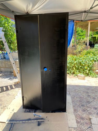

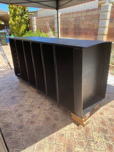

Step 5
I applied two coats of paint.

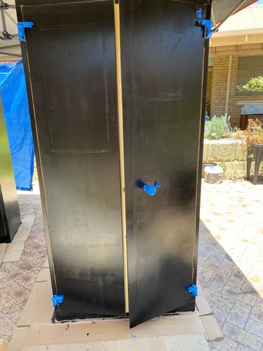

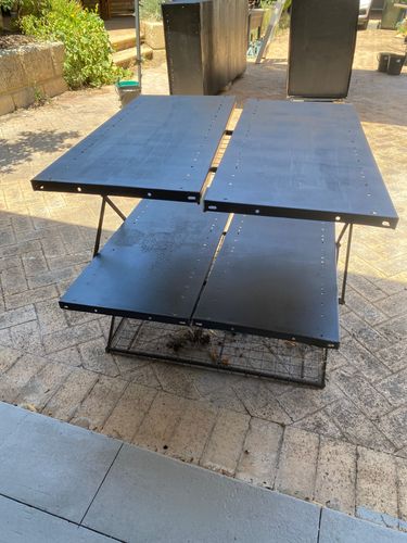

Step 6

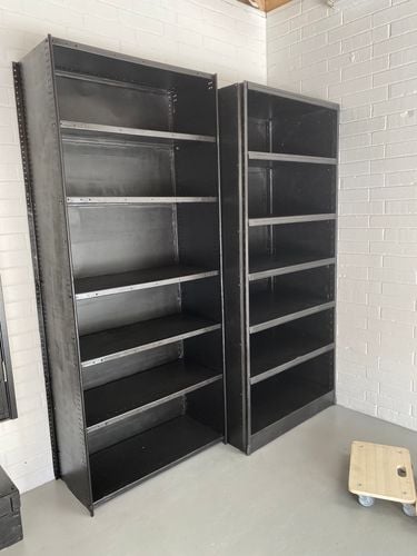

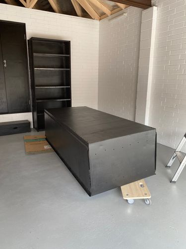

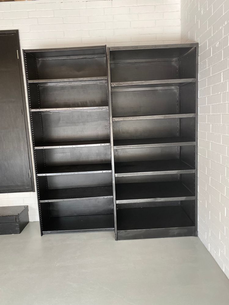

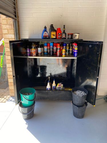

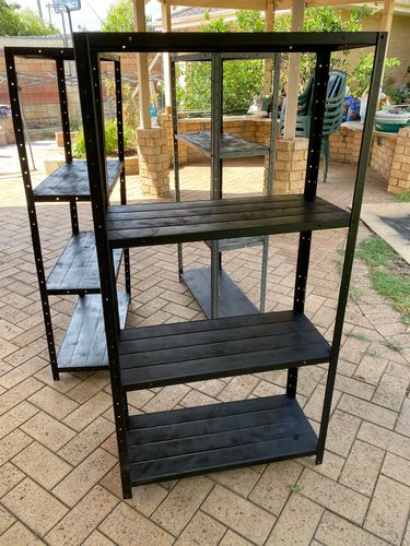

Heaps better, they look brand new !!
I used a couple of dollies to move the cabinets around, made it a lot easier for me 😃
