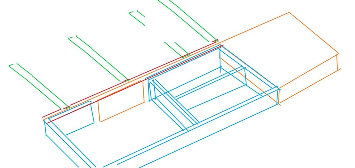

I have two questions regarding the sleeper and the cover/deck.
1. I am using the pavers as sleepers/formwork. (pointed with red arrows). Do you think it's strong enough or should I use the concreate sleeper?
2. I want to have a small deck that covers this area. It needs to be removable if we need to access the door. I think I can't use the modular decking or composite decking since the size is different. Can I use the wood sleep as a frame instead of putting the base frame flat?
