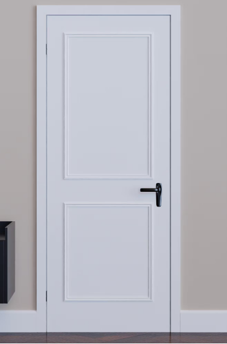

Hi @Jewelleryrescue
there's no current moulding on any of my doors - so I wanted to add some before painting!
Im thinking something similar in style to the below - nice and simple, maybe 3 squares.
Thats a nice choice, 2 or three boxes is a plan both look a treat. 🙂
The closest match to that was
I/N: 0080002
$21.20
But if you type in " moulding " in bunnings on line search you can scroll through other close matches

Thanks @Jewelleryrescue for the suggestions - one more quick question, are both sides of the door normally done? I cant find examples online
Typically Cornathan type doors have Sunken patterns that appear on both sides of the door.
But there are zero rules about this and totally up to your personal newly developing style.
I have Cornathan doors mostly but one door is a solid door so I did like you plan put a raised pattern on the outside of the door and there was no need to put one inside as that room has its own style inside disconnected from the look of the hallway doors.
You may wish squares on the outside and a diamond (Square turned 90degrees on the inside) for a quirky look if you wanted to be a DIY rebel in a good way.
