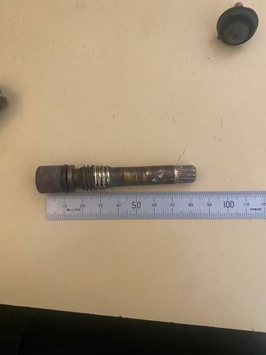

I am looking for a tap spindle. Due to its unique seat depth, the readily available tap spindles doesn’t work. Would be of great help if I can some help in find the tap spindle in the market.

Sad to say taps and tap manufactures have moved away from that type of tap and they no longer really try to support replacement parts Not even Fix a tap components supply these as far as i can tell.
So the best option is to probable buy a shiny new tap complete?
But lets not give up so easy. whats wrong with that spindle? as The o'ring can be replaced the spindle its self can be wire brushed and cleaned up. If the tap spindle a little loose a qucik wrap with plumber s tape on the threaded part will have it close to new.

As @Jewelleryrescue has mentioned, replacement spindle shanks are not readily available. I'm also keen to hear about the issue you are trying to solve, as typically, you wouldn't need to replace a spindle.
Depending on the problem with seat depth, a range of extenders are available if it is a deep seat.
