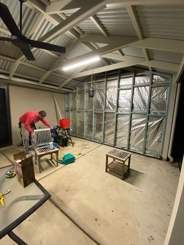

Cupboard fronts from tongue and groove planks also.
Sarking

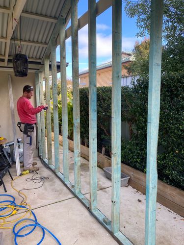

Steps
Step 1

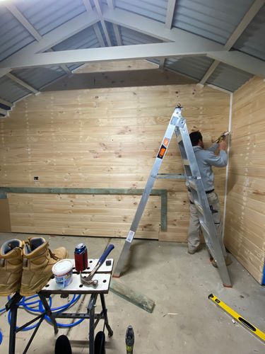

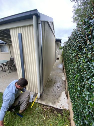

Marked out and framed. Then measured and attached Colorbond to outside.

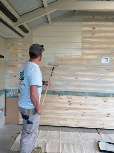

Step 2
Sheeted the framing and painted the Tongue & Groove

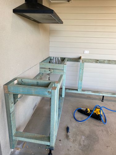

Step 3

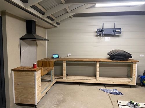

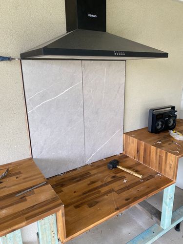

Framed the benches and cupboards. Installed the bench top, rangehood and backsplash tiles.

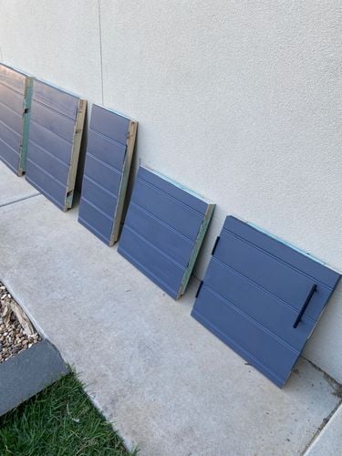

Painted cupboards (whole family affair)
Step 5

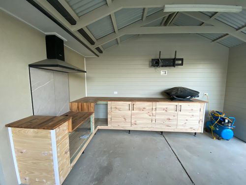

Install cupboard doors. Check out how good the Weber looks!
