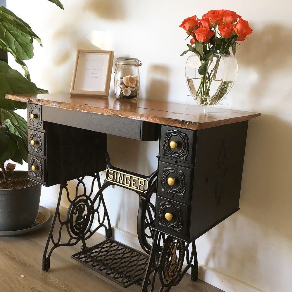

A beautifully restored Singer sewing table, with a brand new live edge tabletop and a working treadle.

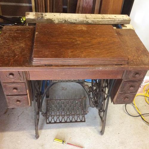

Pull apart table and wire brush metal parts to remove rust.
Use wood glue to reattach veneer. Lightly sand wood in preparation for paint.

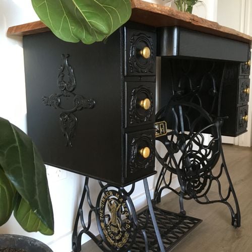

Paint timber and iron in satin black. Detail work (Singer logo, drawer knobs and motif) painted in matte gold.

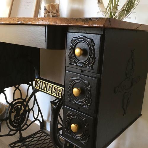

Pour epoxy resin onto tabletop to finish and sand and polish until satisfied.
Reassemble all pieces.

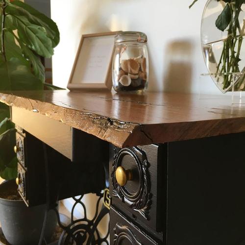

Live edge!
