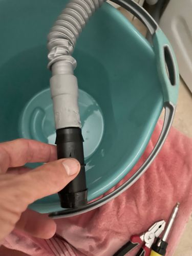

i have a leak coming from my washing machine hose. I have taken the clamps off & re tightened them but not sure what else to do
Welcome to the Bunnings Workshop community @dave011976. It's brilliant to have you join us, and many thanks for your question about connecting a washing machine hose.Your best bet is to try and do away with this connection altogether. There are two potential leak points here, and it would be far better to run one longer hose directly from the back of the washer if possible. Is that expanding hose long enough to do the job by itself? At the back of the machine, the hose on it should just be connected with a similar clamp.
Alternatively you'll need to work out why this joint is leaking, and I suspect it's due to the connecting piece you are using. What's between the two pipes that you are clamping down on? On the expanding hose side of the connection, it appears that the clamp has cut through the rubber collar, and you might have crushed whatever you are using to join the pipes. I've found these Toro 25mm Barbed Joiners to be one of the better options for joining washing machine hoses.Please let me know if you have any questions.Mitchell

So, back to the joiner you've used. I think it's either crushed or the rubber connector on the hose has been severed, allowing water to bypass the clamps. The tighter you do the clamps up, the worse it will likely get. I recommend taking the expanding hose in with you to a store and checking to see if the barbed fitting I linked to above fits in the rubber connector. You'll need to fully push the barbed ends into both hoses and place your clamps over the rubber connector after the barbed portion. When the pressure builds up, the barb ensures the connection can't blow apart.
hi Mitch I've just tried to install the new one & the cords won't go in the connector
, do I need a smaller one

I'm afraid the Toro 25mm Barbed Joiner - Single is too big, I suggest going one size down and using the Toro 19mm Barbed Joiner - Single. You can reuse the clamps that you originally have. Once you've put in the joiner, I suggest doing a quick test and seeing if adding the joiner fixed the leak.
However, if the hose continues to leak, I propose trying to track down if it is coming from the machine side or extension side. If it is coming from the machine side, I suggest engaging the services of a professional handy man to replace your washing machine hose outlet. But if it is the extension hose then all you need to do is replace it with a new one.
