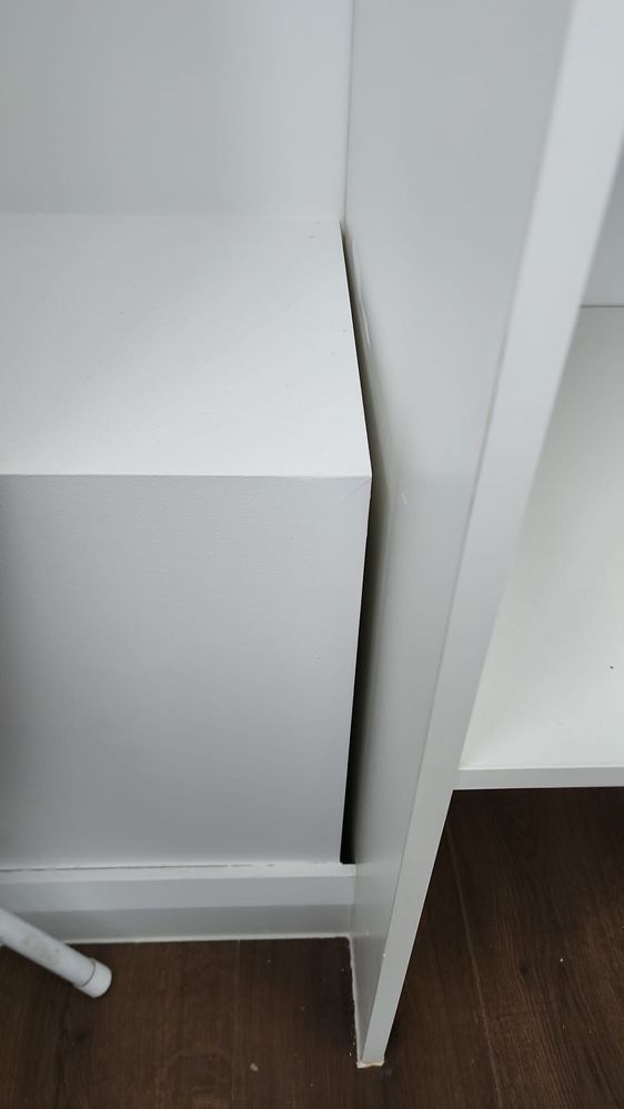

The builder has left a gap in my wardrobe between the wall and the cabinets. how do I fix this?
Hi @atitcshah
What a gap probably to big for fillers unless your keen on a more flush finish?
The easiest way is the flat timber moulding glued into place and painted. Some come pre undercaoted white and you wont need to paint it as a quick fix.
Moulding is a flat piece of timber or can be a curved shape that pleases your eye that completly covers the gap in a nice way. You can glue with liquid nails sparingly and if your timber moulding leaves a smaller gap use no More gaps also use on that crack in photo between skirting board. clean up water and damp cloth and wipe bead of no more gaps,

Welcome to the Bunnings Workshop community @atitcshah. It's brilliant to have you join us, and many thanks for your question about covering a gap.@Jewelleryrescue has beat me to it, and a nice timber cover moulding will bridge that gap. As it's an internal corner, I'd go for a flat section or a scotia moulding.Please let us know if you have any questions.Mitchell
