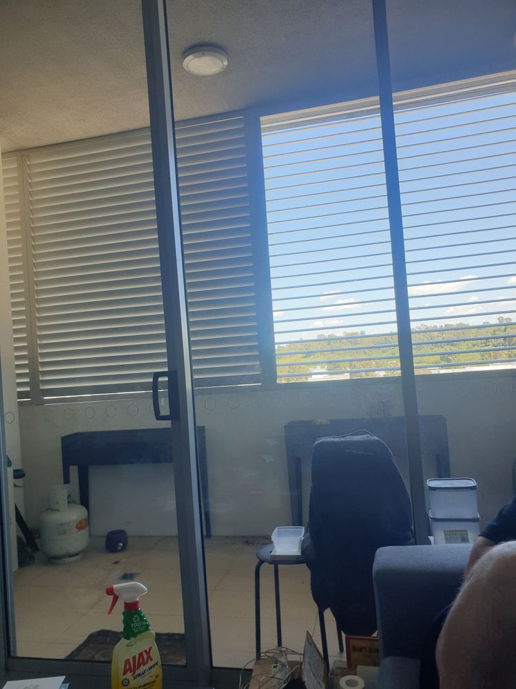

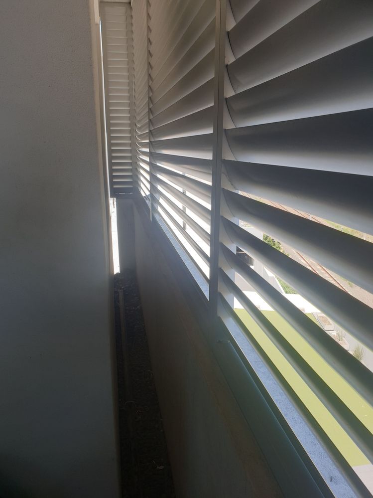

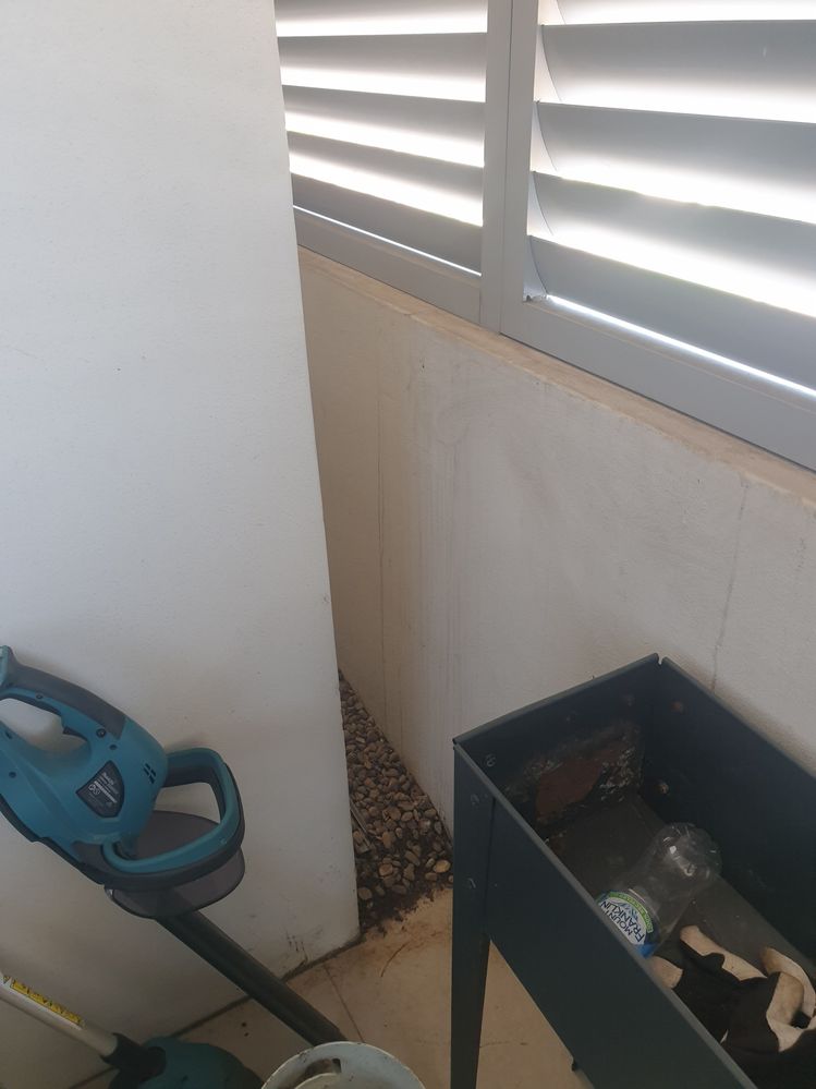

Wanting to cat proof our balcony, we recently bought so we are able to make permanent modifications. Want to block off the shutters so the cat can't fit through them as we are on the fifth floor, but also want to be able to open them for the light. Also wanting to block off the gap down the side of the balcony. It is too narrow for us to get into and clear out but a cat would fit.
Any suggestions would be greatly appreciated. Thank you in advance!

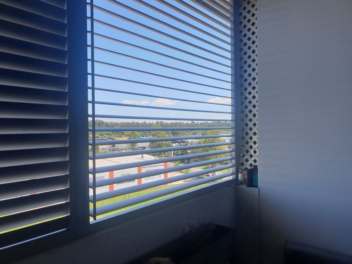

Could you close the gap with lattice to match the other side? For the shutters, maybe large (wire or cat proof mesh) flyscreens you could slide across on U channel top and bottom to access the shutter fixings then slide back

Welcome to the Bunnings Workshop community @rachell505. It's sensational to have you join us, and many thanks for your question about cat-proofing your blinds.I think @Christine61 is on the money here. You'll need to create a frame around the shutters and proud of it to which a mesh can be added. A small port can be made in the mesh or frame to allow access to the rod that actions the shutters. Or, having the frames mounted in channels so they are movable could also be the go.
I also like their idea of using a lattice to close the gap and prevent access.Please let me know if you have any questions.Mitchell
