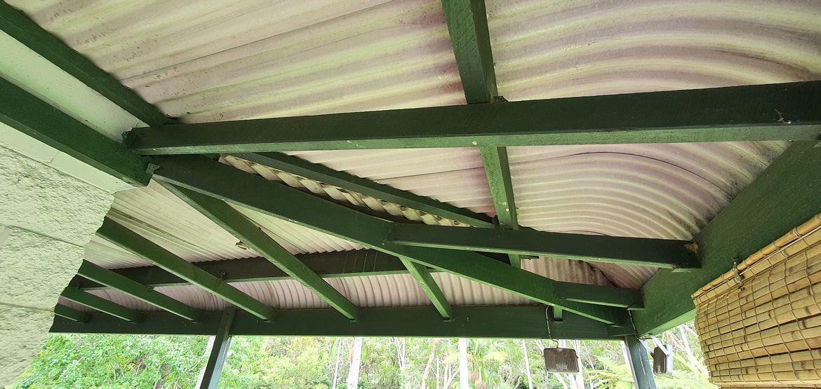

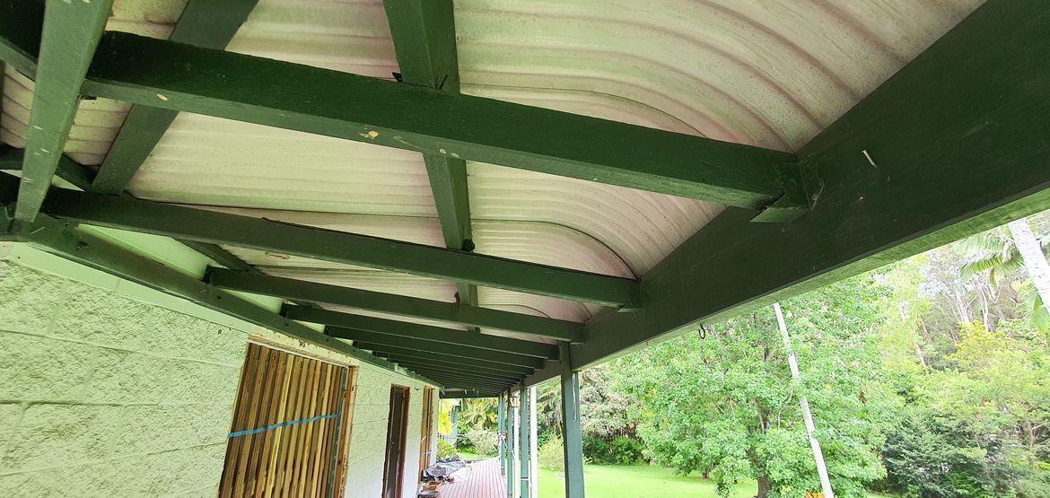

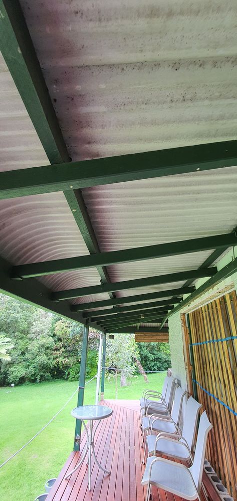

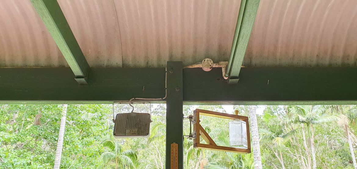

We have a three-sided wrap round deck with bullnose roofing (each side is 4m long and it's 17m long on the front). From exterior house wall to outside deck facia beam, it's around 2.0m long. There is absolutely nothing consistent about the spacing between the rafters - or anything else about our house for that matter - so sadly, it's not a matter of simply buying 900mm wide insulation panels and slipping them in between each. Spaces between rafters range from 780 to 880 (I think, haven't measured them all). Power runs along one of the rafters and is then channeled on top of the facia beam (under the roof) to 3 or 4 flood lights that are also attached to same along the length. The corners, where the hip rafter is, might make installing insulation and a ceiling complicated? Photos are attached. I was thinking that the simplest ceiling option is installing insulation close under the roofing somehow, then slipping the ceiling panels in above the facia beam (where it would sit above) and screwing the panel into the bottom of the battens. This would leave most of the rafters exposed, but not the battens.

Corner with hip rafter
Along front length of deck
power and lights to work around
Another along the front
