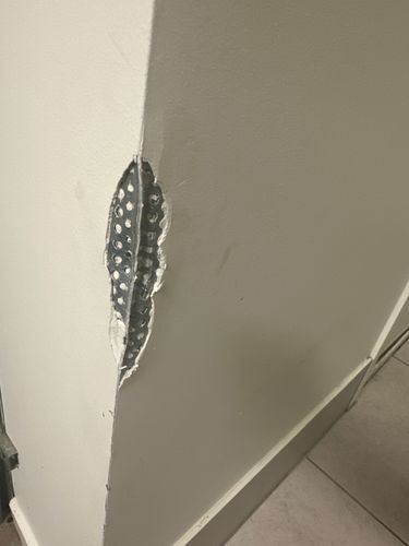

Hi can anyone please suggest me how can i fix it up? I hit my car in it
Hi @harry6
It is a simple repair foryou
All you need is some gyprock repair a flat bladed trowel and some sand paper

Mix up the plaster and fill in the hole and shape it to form a corner let it set sand it if it isnt perfect add some more plastter to wall and try again
Welcome to the Bunnings Workshop community @harry6. It's great to have you join us, and many thanks for your question about repairing plaster.
It's really as easy as @Jewelleryrescue has mentioned for the plaster repair. However, I think your image doesn't fully reveal the extent of the damage. I can see that not only is the plaster cracked and has fallen away, but you've actually bent the corner trim fairly substantially, creating a bulge in the wall.
In order to create a seamless repair, that trim might need to be whacked back in the opposite direction to try to re-align it with the corner. Or, you might be able to work with it as is, but I suspect you need to do a fair bit of filling and sanding to conceal the bulge.Please let me know if you have any questions.Mitchell
