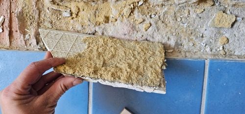

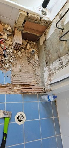

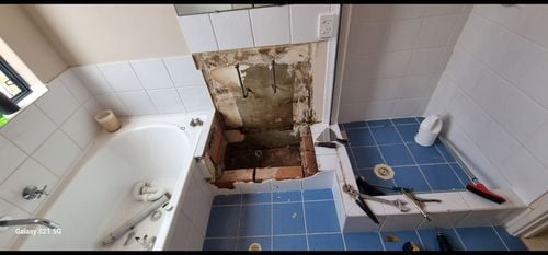

Hi so I have been in my new house 5 months, i started a renovation on my main bathroom because the vanity on the wall sitting on a tiled brick ledge that atached to the bath on one side and on the other side it followed around to create a shower hob, had to be removed because it was badly rotted. So after removing the vanity it was a mess the way they have slabbed bricks and cement together witch holds the bathtub.

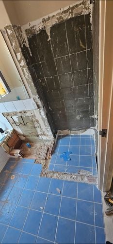

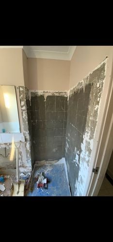

So I removed the shower hob, and shower screen, shower wall tiles wictch were mouldy from the plaster under the tiles witch I have scrapped clean

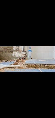

So now I have to replace bathroom floor tiles, under tiles is a yellow like sand/screed and after removing the hob for the shower I'm left with 2 diffren levels in the bathroom because the shower floor is higher,
once I have removed the floor tiles do I have to remove the screen?Dose the screed have to be fully removed back to concrete and replaced ? Also I want to replace the bath but how is this possible with the way they put the sides together for the tub witch stick out buy like 2cm, and the brick thats still attached. I want to still put a bathtub in and not have to move any plumbing
