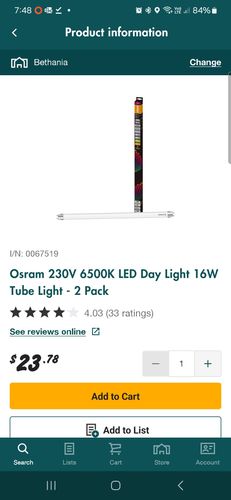

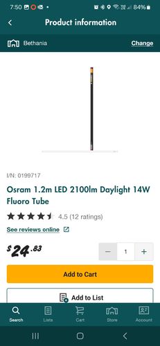

Ok there are a few options depending on what size you are needing.
Guide for retro fitting fluro to LED
1. Don't compare watts with watts it doesn't apply with fluro to LED
2. Does your existing fitting have a starter? That's the little cylinder thing that sits under the tube either in the middle or 1 end? If so great that make life easier.
If not you have an electronic ballast and there is no guarantee that the tube will work so be prepared for that and don't get disappointed.
3. How old it the actual fitting? Are the tombstones falling apart either end? If yes don't bother retro fitting a tube just replace the entire fitting with a LED batten fitting maybe a Tri-Color so you can select the colour you want.
4. If replacing the tube then majority of older tubes are a standard T8 and standard diameter but some older ones are fatter than Augusta from Willy Wonka so length is the go, you can establish the length of a fluorescent tube by measuring the total distance between the two end pins. The lengths of these tubes are commonly indicated by the wattage. The smallest fluorescent tube is the T2 and it has a length of between 250mm and 760mm. The next longest tube is the T4, with a total length of anywhere between 150mm and 1,500mm. This is followed by the T5, with a length of between 340mm and 1,800mm. The length of the T8 tube may be anywhere from 600mm up to 2,400mm.
5. Colour what colour do I need? 6500k is white like hospital white, 4000k is Daylight, 3000k is Warm White like orange. But I'll let you in on a secret walk into the globe isle of Bunnings and there is a lighting colour chart up above the globes with the colour examples 😉
6. When you find the tube plllleeeaaasseee check the new tubes for cracks and breaks and also that you have an electronic starter for each globe you need it. These tube packages get damages and dropped by people's and started grow legs so don't be disappointed when you get home.
7. Keep your receipt just incase.......
8. Follow the instructions to a TEE.....
9. Never perform Electrical work apart from changing the starter and tube.
10. If unsure take your tube in and compare, ask for help.
Hope that helps
