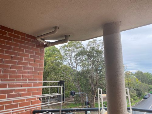

Yes I already have a drill (bought one just after reading the article shared above),
Now my biggest question is what is the right size of drill to use on a building structure like my balcony brick wall and the concrete pillar?
I don't want to cause any structural damage.
Also do I just drill anywhere? or should I check where are the metal possible behind the Concrete pillar?
I will be attaching few brackets to hang curtains using ropes on the top and the bottom to create a boundary enslosed effect from having open air.
Thank you so much!

Would you please let us know what type of drill you have? Typically, you'd use a hammer drill for bricks, and with that style of drill, you'd use a masonry drill bit. The right size of drill bit would be the one that suits your intended fixings. I see you'll be installing brackets and the fixing must be suitable to that particular bracket. These masonry plug kits will often be suitable, and they conveniently include the wall plug, drill bit and fixing. Just make sure you pick up a kit where the screw fixing is a suitable size for your bracket.
When drilling into brick, there is always a chance that there could be electrical cables and water pipes within the wall. There's no definitive way of determining what might be inside the wall. If you are concerned about potentially drilling into them, I'd recommend you consider enlisting the services of a professional to mount the brackets.

I currently have a Hammer Drill.
I have not used it before though.
I am now more concerned about applications whether it will cause any issues structurally and also it will be considered as “major or minor” work by the strata.
strata guidelines says - hanging pictures is not considered as major but minor which doesn’t not require strata approval.
I believe this amount of work attaching a hook or holders will be considered as minor work? What is opinion?
I can't imagine placing a few holes in bricks would cause structural issues; it's not as if you are removing bricks. You might like to check with a strata committee member, but I would assume drilling holes for a bracket would be similar to drilling holes to hang a picture. I'd suggest checking with them if you haven't seen other balconies with hanging plants, as that might not be something they allow. Sometimes, strata like to ensure that all balconies look the same.
