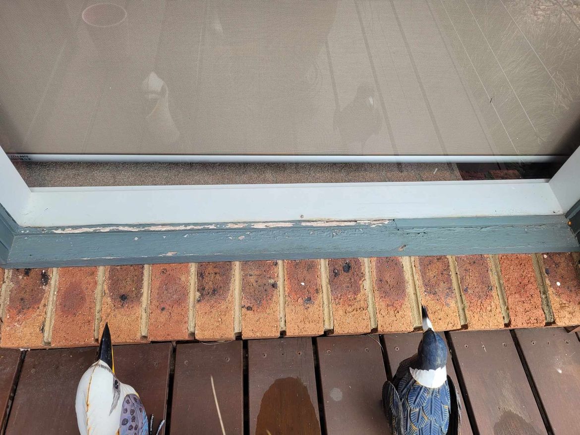

I have two window frames which appear to be rotting (?) at the bottom of each. Do I only need to replace those sections and if so, is it difficult?
Hi @JenD
If you tap the wood is it solid or very mushy? if solid great. if not replace need to dismantle window frame to take base off not real easy.
Your timber looks fine just needs paint scrape back and repaint. that white looking strip is the orininal window putty and timber strip simple to smear outdoor no more gaps on the timber surface to make it look flat and then repaint. Cute birds.
Thanks again!!! I will tap the wood as suggested and take it from there. Hopefully not a replacement job!!! Oh & thanks for the bird complement - now to keep the cockies away hey!!

That's excellent advice coming from @Jewelleryrescue. Just to add to the suggestions made, if the timber piece is only marginally rotten it is possible to rebuild it with Earl's 250ml Wood Hardener in combination with Builders Bog.
However, if more than 1/4 of the timber has deteriorated then its best to replace it with a new piece.

I'm not sure if you've completed your project yet, but I thought I would drop a message in regards to working near glass. It's imperative that you take all precautions to avoid the risk of damaging the glass and having it shatter. If you tap the timber with a hammer to check its integrity, I'd certainly use a timber board to protect the glass, as one inadvertent tap could cause it to shatter.
Also, please wear adequate PPE when working around the glass, including cut-resistant gloves, a long-sleeved shirt and trousers, enclosed footwear and safety glasses.
If in doubt, please consider enlisting the services of a professional to perform the repair.
