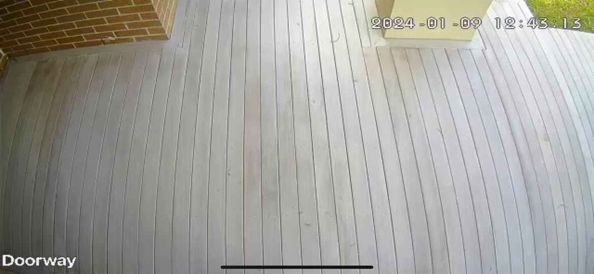

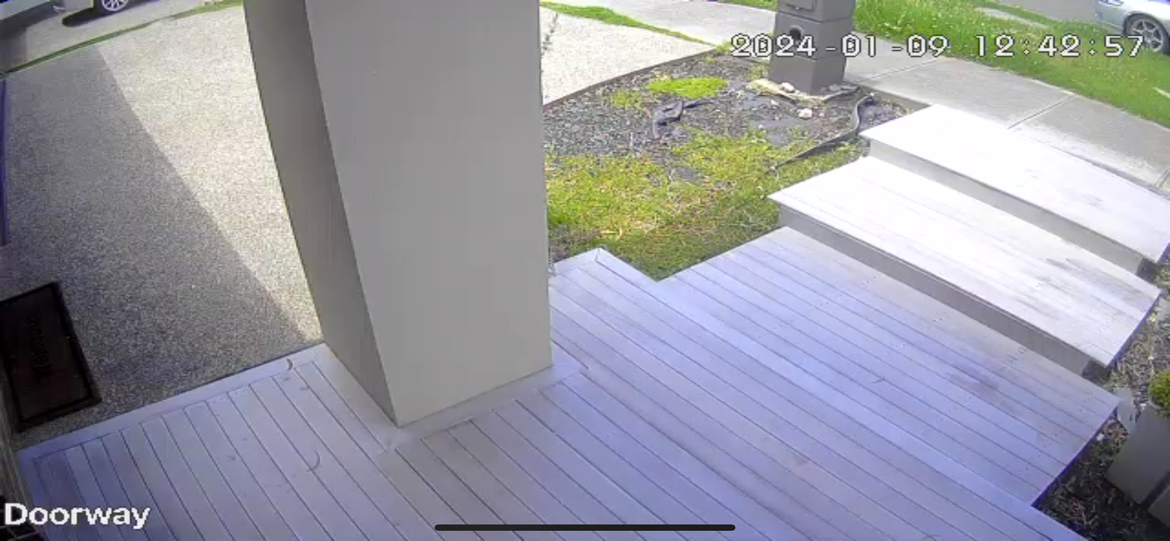

I have changed the finished on my front entrance merbau decking that has seen better days. It was originally finished with Intergrain Ultradeck Merbau Decking Stain
I did the following:
1. Clean deck using Integrain Ultraprep Tannin and Stain Remover - which TBH didn't do anything...
2. Strip varnish with Polystrippa Paint Stripper
3. Sanded using 40grit on the decking sander I rented
4. Cleaned again using Cabot's Deck Clean.
5. After overnight drying I applied several coats of the Cabot's Deck & Exterior Stain (Beach house) as directed. This is a PITA to apply, very hard to get an even coat. I had to sand in between coats to remove bubble and streak marks...
So after the last coat dried, then next day it rained. I noticed the deck surface was slippery...
How do I fix this? Not really happy with the overall result... But I don't like to do it all over again as I don't want to waste the money I already used.
Please help.
