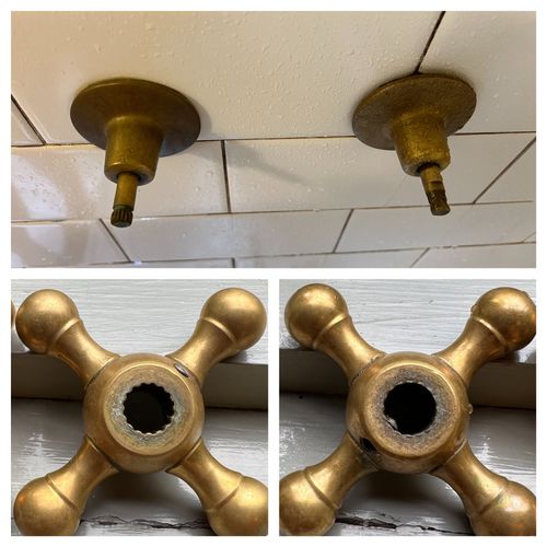

hot and cold handles with cartridge stemsAn issue that has plagued us, is the cold water tap in our shower.
It's a heritage home, so we have brass handles, faucets and shower heads.
1st: The hot and cold taps are a different style. You can see that they have different depths
2nd: the cold tap cartridge stem (is that the right name), is worn down completely, which even when the handle is tightened with the hex grub, it only just functions in turning.
3rd: the cold water tap has likely a worn washer, which is causing us to have to turn extra hard to shut the water, which is only making #2 worst.
So my question(s) is/are:
* Which of these styles are more readily available?
* Can I replace just the stem?
* Is there a good source of these cross-bar handles in vintage style.
