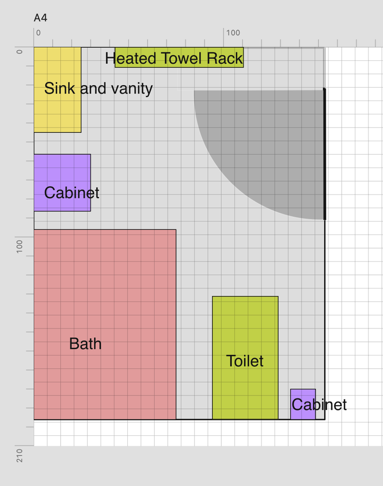

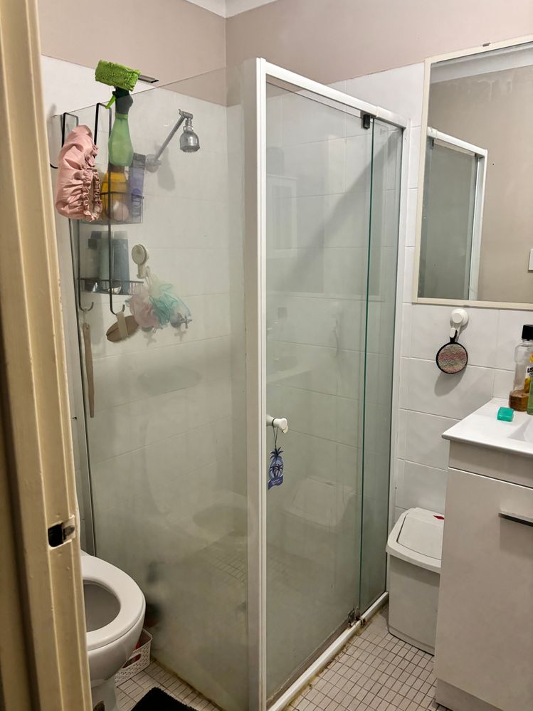

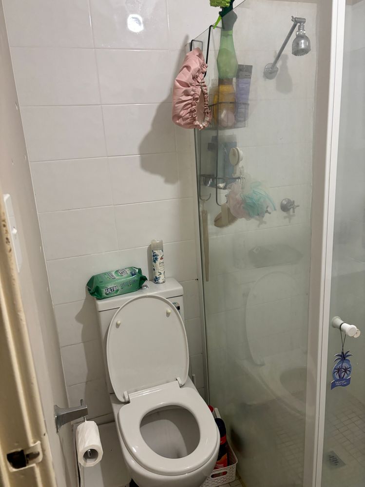

I would like to redo my bathroom on a budget. I know that the floor is uneven and will need to be redone but I wonder what gets done first if I want to change my toilet, put a short narrow bath, add a tap (but keep the shower) change vanity/sink but that is not mandatory.
.New plans

Great work on doing the very first step is to plan out how you want you bathroom to look with a drawing with the space avaliable measurments
So then when your shopping for new bathroom fittings you can show people exactly what you have and then you can pick out workable solutions,

To start you off if you combine the shower in to the bath space you might have a better use of the space.

The first items to be done depend on the extent of your renovation. Do you plan on changing the floor tiles? If so, everything needs to be removed right back to the waterproofing layer. So, the toilet, vanity, shower, and then the floor tiles come off. You'll also need to consider if the wall tiles are changing too. Waterproofing is redone, then tiling, toilet going in and bath, then vanity.Please let us know if you have any questions.Mitchell
