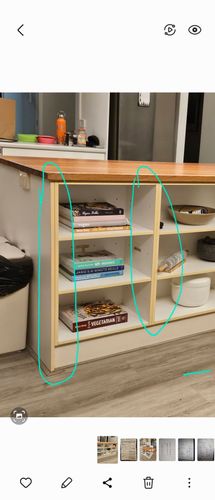

I am wanting to paint these melamine edgings back to the white.
What kind of paint do I need to get? And would a paint brush or small pain roller work better?
Hi @jesskate88
That edge looks like it was painter allready which is good as you wont have to undercoat a melamine edge.
All the acrylic paints on the market are pretty good and clean up in water. Can I recommend you buy a sample pot of paint in the color white you choose as sample pots are less expensive than 1 litre paint tins.
A small brush will work well her as there is less cleanup. But feel free to use a small roller if you want.

Welcome to the Bunnings Workshop community @jesskate88. It's brilliant to have you join us, and many thanks for your question about painting melamine.As mentioned, melamine (plastic) typically requires a special primer. You'd then be able to paint over it with a suitably hard-wearing enamel paint. Please let us know if you have any questions.Mitchell
