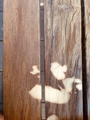

Surface on left is sanded back and plank on right is current untreated not sanded surface.

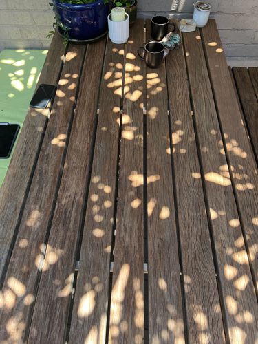

First time here and looking for some advice on restoring this second hand hardwood and stainless table.

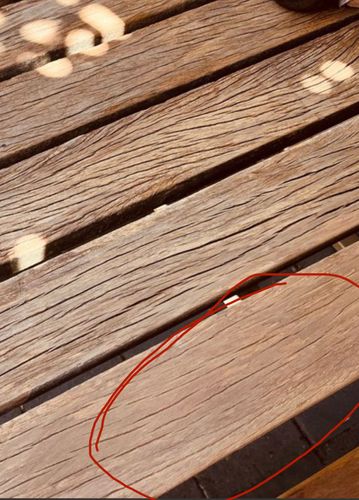

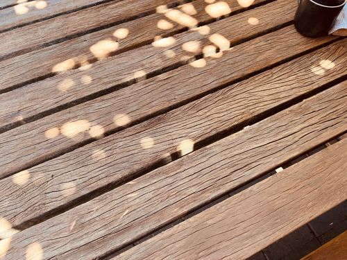

First type of wood. The seller says this is teak which I dont believe as the colour of the wood is too dark. I believe this maybe jarrah. Thoughts? The up close pictures of the surface shows sanded back surface on one piece vs the current heavily weathered surface.

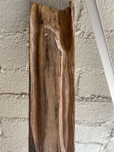

Two; how to restore the wood. I planned to start by removing all slats which are screwed in. Wet the wood well and then gently pressure wash. Followed by a hardwood cleaner and light wash.
Then I planned on sanding all surfaces and saving the sandings. I require some advice on the heavy cracking on the surface. Should I fill with a clear wood glue coloured with the fine sandings as concerned a coloured putty with this level of cracking would not look nice on the surface. Alterntaively I have seen people recommend an epoxy but concerned as being outdoors partially shaded that it may discolour in the sun. But thinking uv stabilised epoxy that is applied with spatula then sanded down between coats, this would then fill the gaps and then allow the majority surface to take the stain. What would be your advice? Another option I just thought about is flip all the planks and use the surface on the bottom as the top surface. Then just reputty the holes.

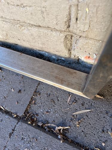

For the stainless frame. Using a scouring pad and something like the 3m stainless steel cleaner and polish.
