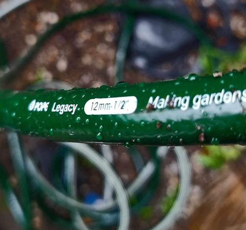

We bought the Ryobi pump. Model Name : Ryobi 750W Clean and Dirty Water Submersible Pump RSCD750Model Number : RSCD750What hose or pipe or connector should we use with it? Our Pope Legacy 12mm hose is too small.

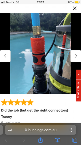

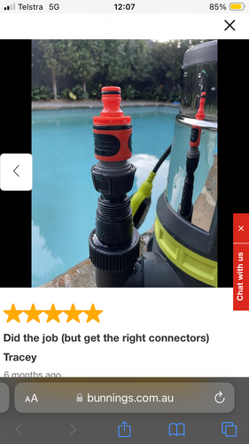

Thank you. We also came across the following review on the Ryobi pump. Any thoughts? We couldn’t find the products referred to.
“The product photos showed it using a garden hose. Took a while to work it out with a v helpful Bunnings staff member but got a Gardenia 19mm w/stop valve (item: 18214-25) and a Pope 12mm 2 way coupling = an extra $22”

I'm not entirely sure what they've done there, but it looks to be a bit of a hack. They've left the barbed fitting on the unit and got a GARDENA 19mm Hose Connector to attach to it. That's a bit of a cumbersome way to attach the fitting, but I guess if it works, it works. I'd suggest that it would leak quite profusely. A Pope 12mm 2 Way Hose Coupler is then clicked into the Gardena fitting to let you click your standard hose on.
The correct way to do it would be to cut the barbed section off the pump outlet adaptor to give you the threaded section below it. You'd then use threaded reducers to allow a Pope 12mm Universal Tap Adaptor to be screwed on. Your hose would then click on that. Using threaded connections means no leaks. The caveat to this would be I could determine the fittings needed in a couple of minutes if I were in-store with you, but it's difficult to know when the thread size on the outlet adaptor is not provided. If you speak with a helpful team member in-store they should be able to assist you.
Taking a closer look at the available images, it does appear that if the barbed section is cut off (as it's designed to be) then the Pope 12mm Universal Tap Adaptor should screw straight on.
