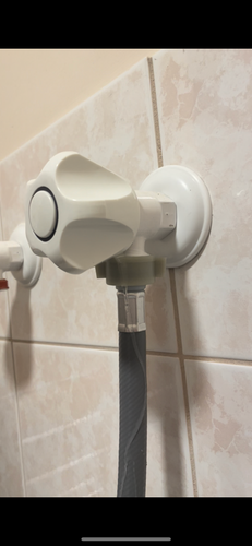

Hello, we’ve recently moved into this place and have tried to set up a new washing machine but the hose is leaking at the tap end. We’ve tried plumbers tape to no avail. Any advice on how to fix this would be much appreciated!!
Hi @dizzydance
Turn off water first ie the tap above
You need to tighten that screw on hose much tighter so the washer works, Try using your tools to tightnen it pliers, multi grips if your fingers give out.
Wrapping a cloth on it to will help with grip.
Well that screw thread is a pressure fit that compresses a rubber washer inside the fitting. Do you see a washer inside the hose fitting in a rare case it could be missing needing a replacment.
Tighten it first I am sure it will work 95%
Welcome to the Bunnings Workshop community @dizzydance. It's brilliant to have you join us, and many thanks for your question about a leaking hose.@Jewelleryrescue is on the money there. Either you haven't tightened it enough, or the washer is missing or perished. Try tightening first, and if that doesn't resolve the issue, replace the washer. When you do so, remove the plumber's tape, as this type of connection doesn't need it, and the tape will actually make it leak more as it prevents the washer from being compressed. The water isn't coming from the fittings thread, which is what plumbers tape seals, it's coming from where the hose enters the fitting. It's the washer's job to seal that area and the pipe threads.Please let me know if you have any questions.Mitchell
