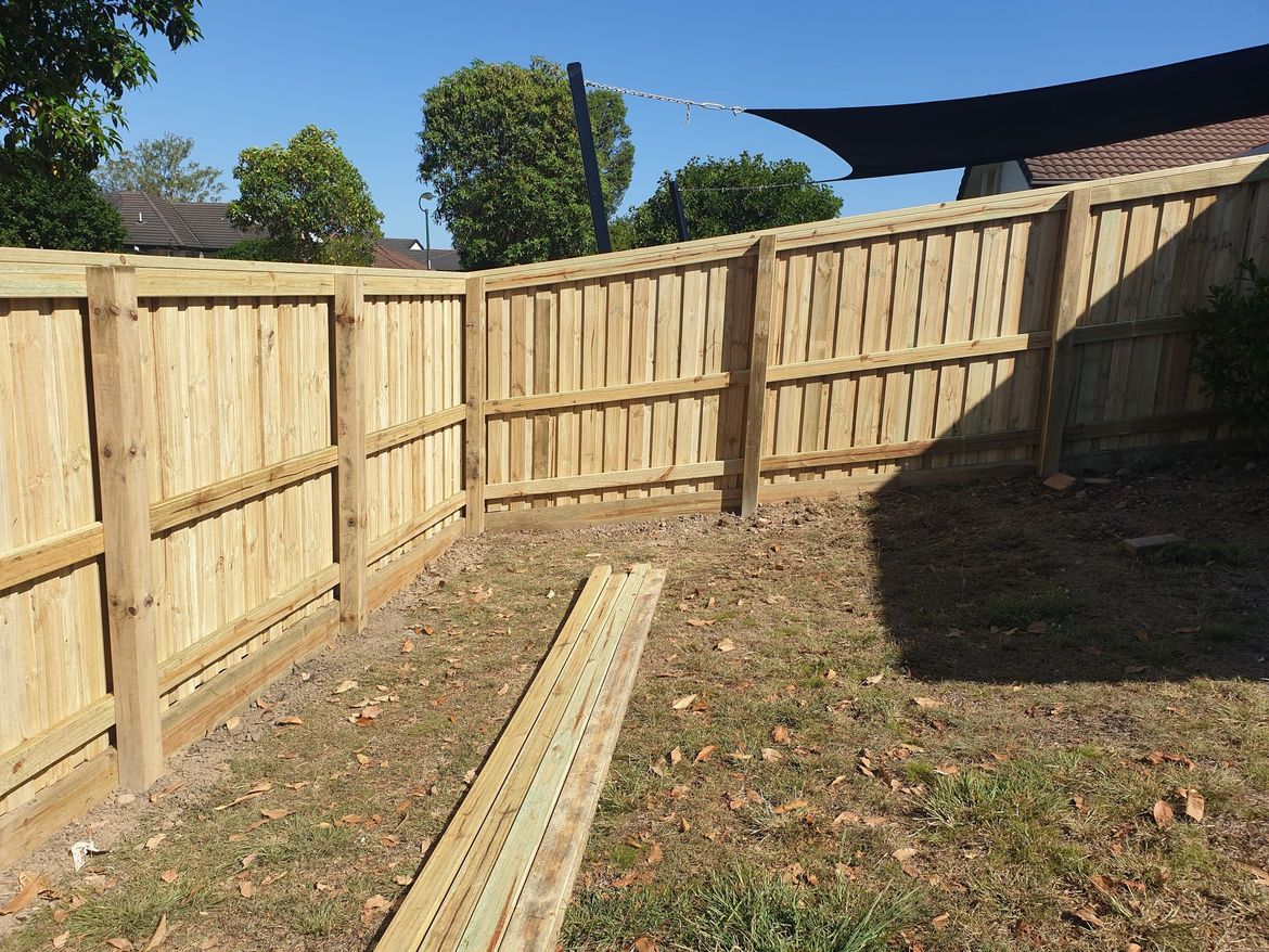

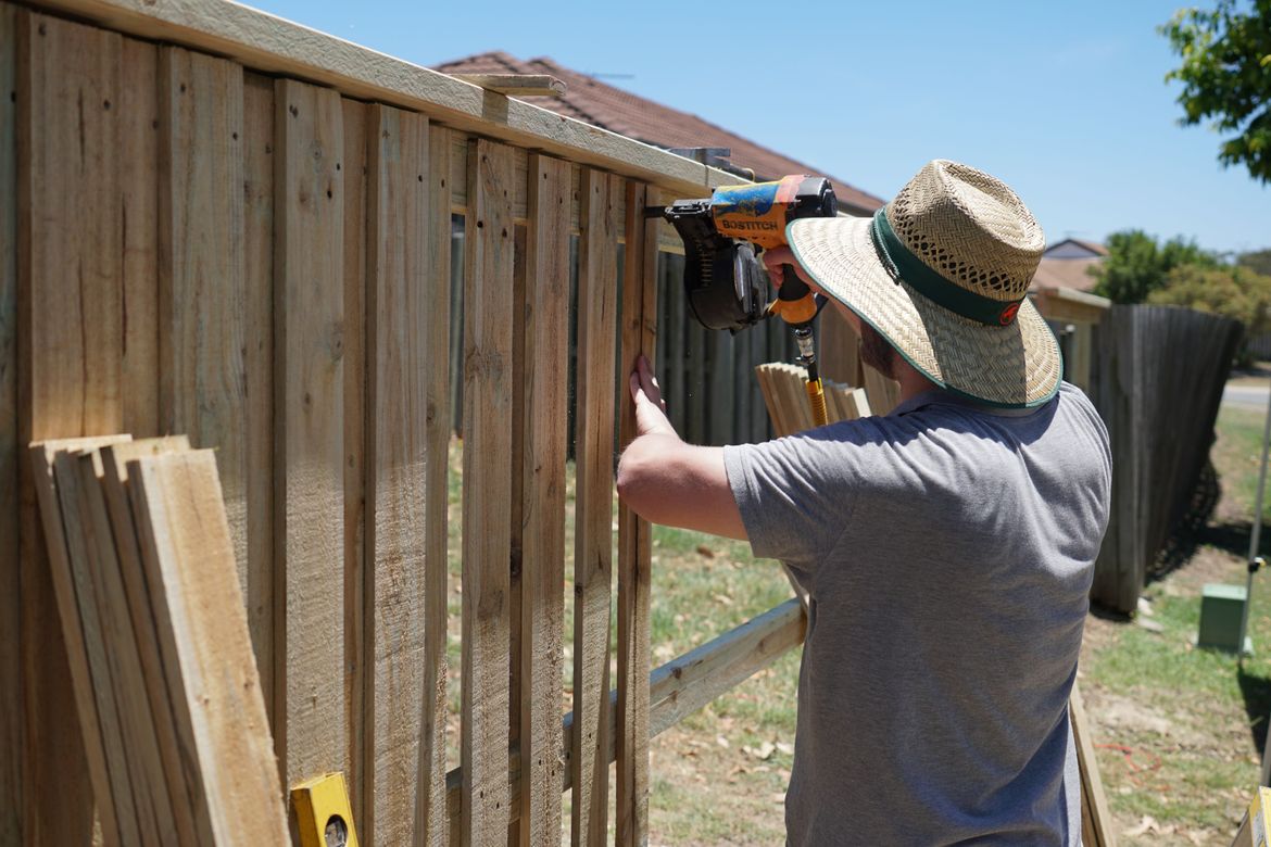

We then connected each post with the horizontal beams before getting to work on the panels.
To my delight, my wife's brothers and father came along to assist in the build, making placing this up a lot faster.
By the end of the day, we had completed most of the panelling, giving us a lot more breathing room on the final day.

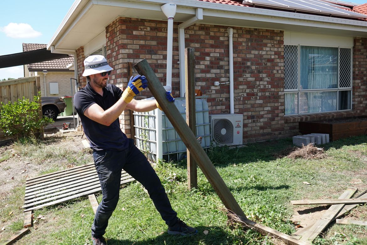

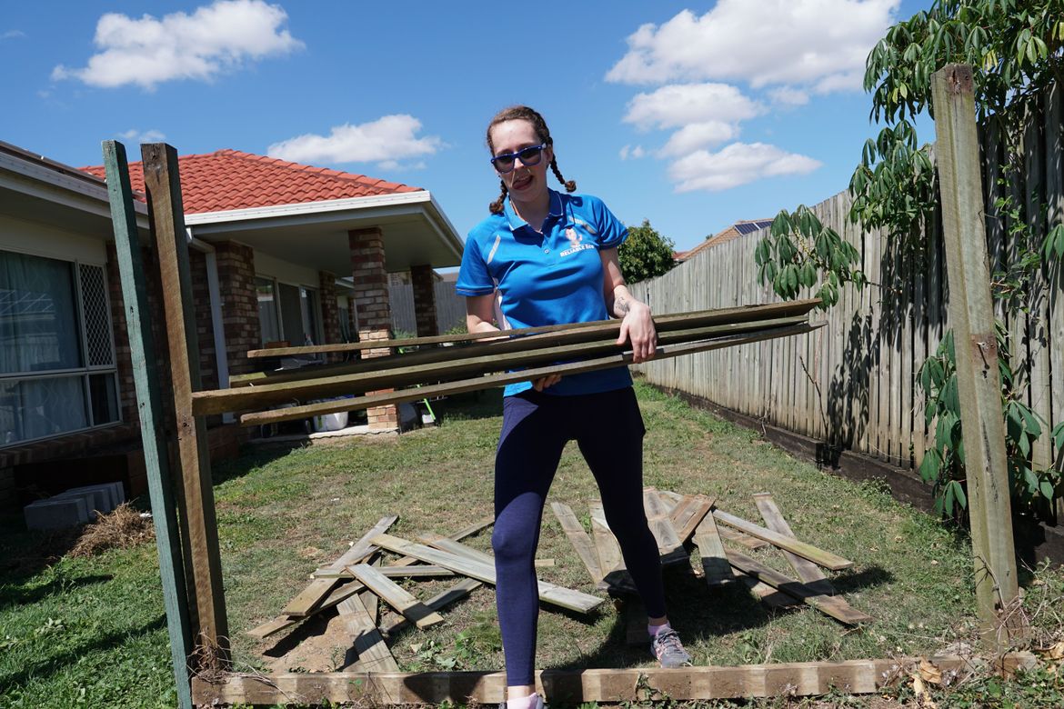

We had to remove the old fence and side access gate.
Cutting and removing rubbish.

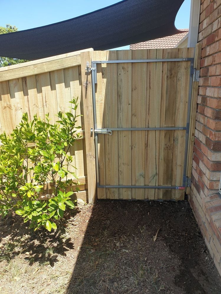

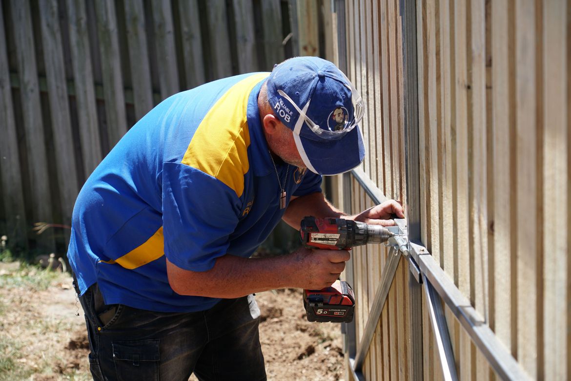

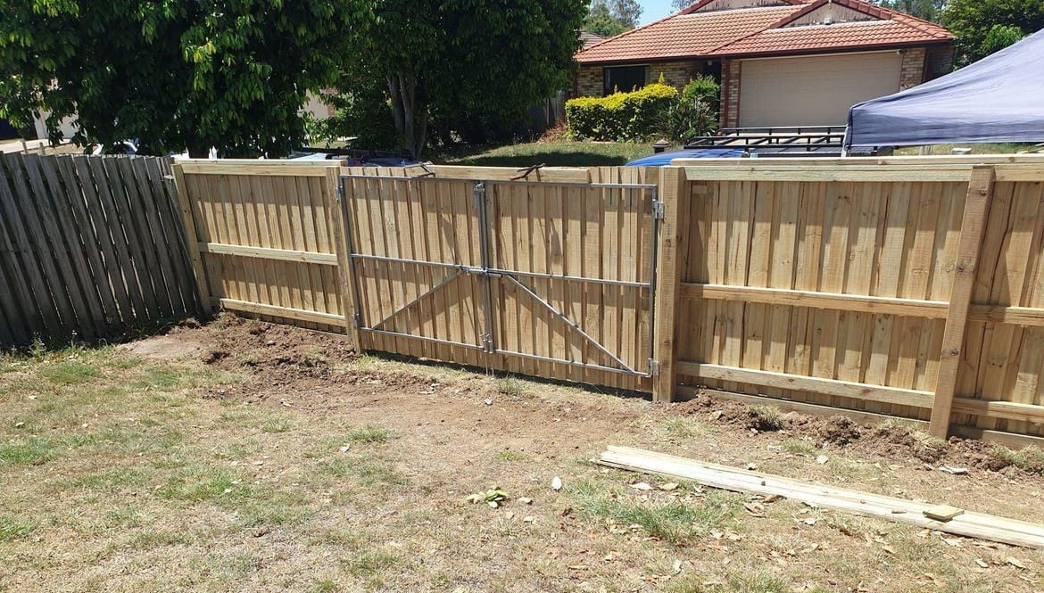

Creating the frame of the gates, mounting them, panelling them and ensuring they can function/lock.
Side access gate.

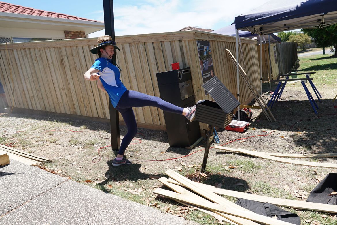

Removing the old letterbox.

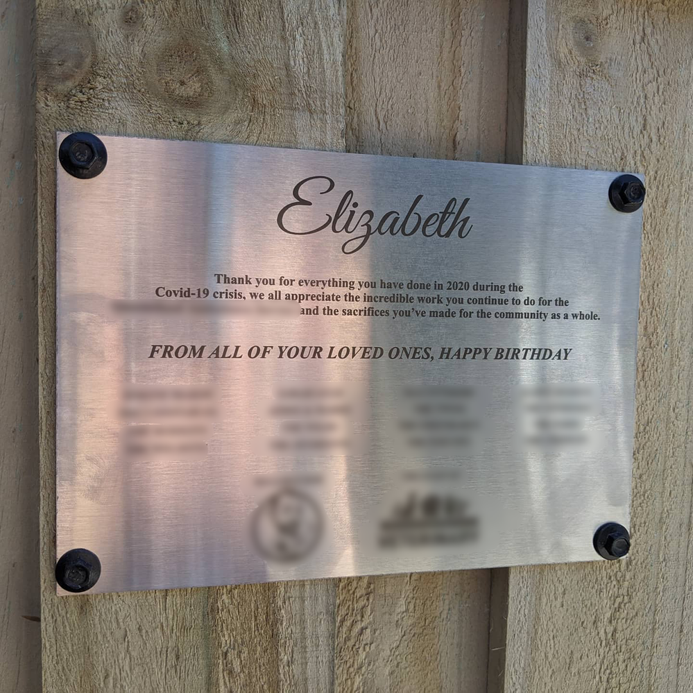

And installing a nice plaque with the names of the people and businesses who came on the day and helped build the fence or donated money towards its construction.

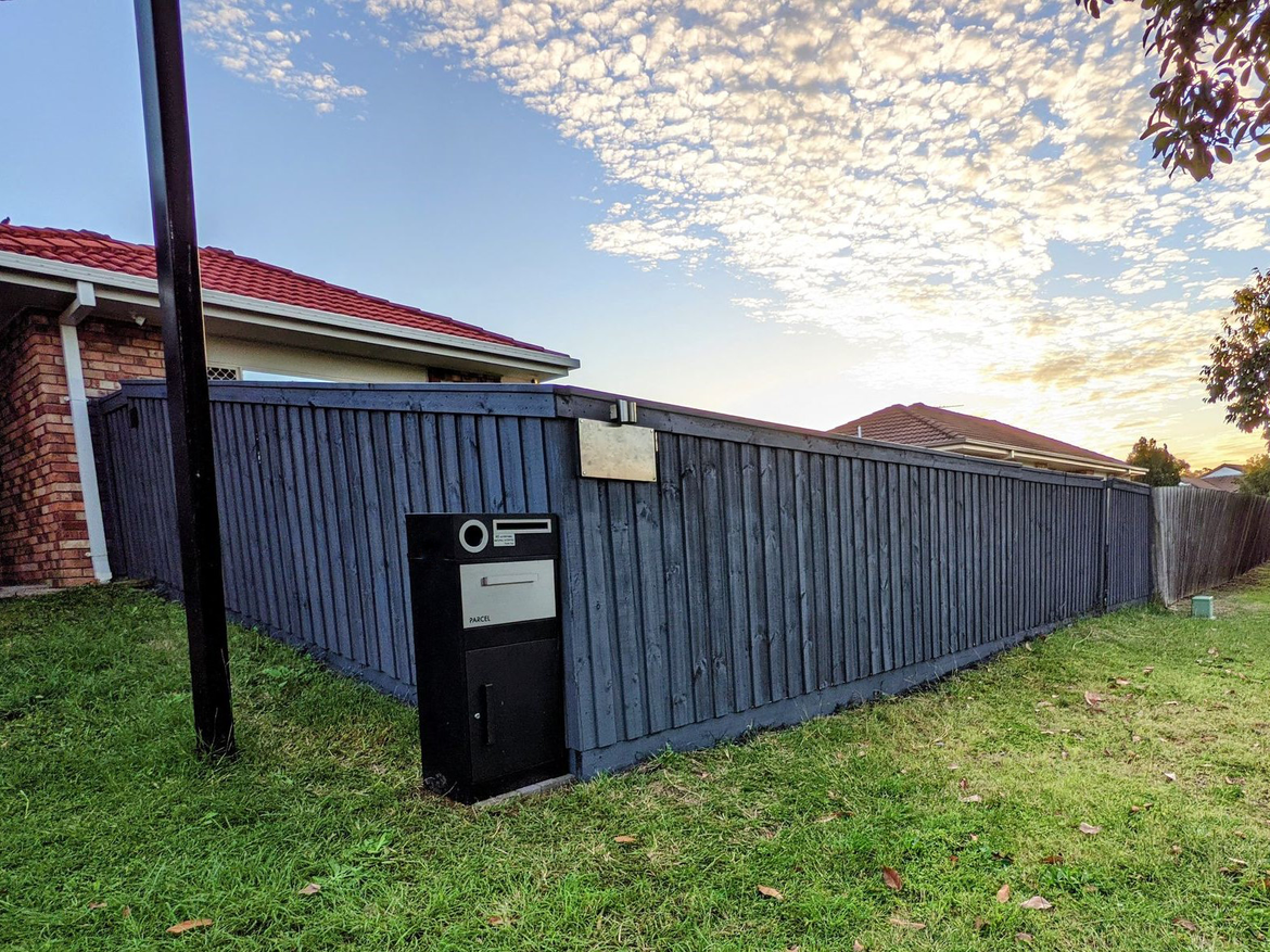

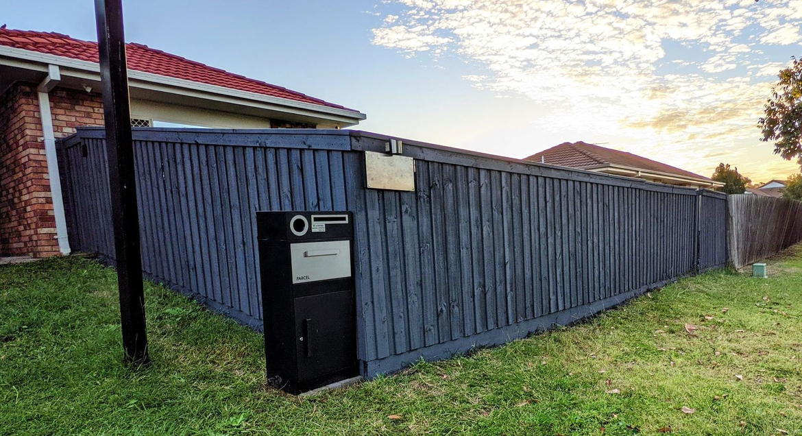

In total, this fence cost me about $1600, which includes the digger, sleepers and rails, gate locks, timber, fixings and screws. I purchased the new letterbox on the day and properly installed it after spraying the fence with a double coat of paint to protect it from the sun. It will also eventually feature a nice, brushed street sign that illuminates at night, making finding our home easier at night.
The biggest thing for us was an increase in the value of our home, for what this fence cost versus what we gained on our property report, it's easily one of my top picks for a suburban D.I.Y. to increase the value of your home.
The fence was an instant head turner in our street, being the only painted fence of its style in our street. It is so much sturdier than the friendly neighbour fencing that is standard in the area. Our dogs enjoy their new play space, and we enjoy being able to park our trailer inside our gated backyard. It was a pretty big effort from everyone but it ensured we got it done. The vehicle access was very needed for our back garden. It's quite a distance to carry 10+ bags of whatever garden project Liz is doing on a given weekend. So, changing that up and being able to just drive in, unload and reverse out has made getting materials up there so much easier. Parking the trailer in there is just the bonus.
