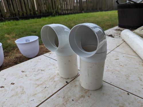

Start by cutting the 90mm PVC Pipe to your preferred length and give the edges a good sanding for a smooth touch. Then, simply pop the PVC Elbow onto the PVC Pipe – it fits snugly, and you can use glue if you want, but honestly, the elbow holds pretty well on its own. This step is all about making sure things look good and stay put, so don't be afraid to trust the elbow to do its job without too much fuss.

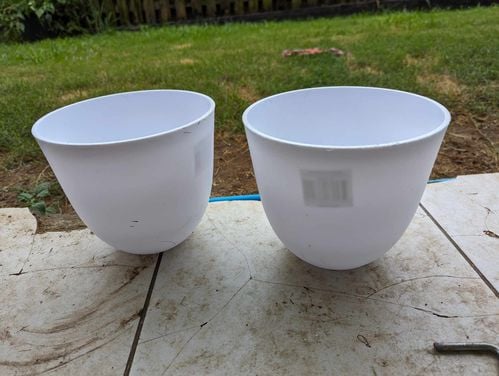

Get your chosen planter ready for action!
Start by adding a bit of concrete at the bottom, mixing it up with some water. Keep going until you've got a height where the PVC can comfortably fit without sticking out from the sides once everything sets. Your guests need space inside that pipe, this is why we don't just fill it with concrete and place the PVC inside. Once the pipe is in place, add more concrete and water on the outside until you hit your desired height. Quick tip: I went a bit overboard with water (thanks, Queensland weather), and had to drain off the extra after snapping the pic. Just watch out for that in case it's rainy!

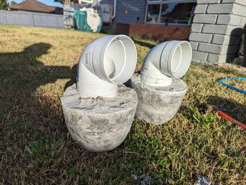

After letting the molds dry for a day, I was keeping an eye out for that perfect light grey shade. Once satisfied, I simply flipped them over and easily pulled out the molds, ready to be reused for more frog hotels down the line—pretty cool, right?
I was super pleased with how the first two turned out!
Thinking about the frog comfort, I decided that the concrete bottom would be rough for the frogs, so I went for a more frog-friendly vibe by placing three smooth Tuscan white pebbles in each pipe. Gotta make sure they have a cozy spot to chill!

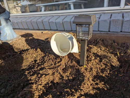

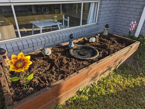

Finally, it was planting time! I found two perfect spots, and my not-quite-2-year-old helper eagerly started digging soil from his raised garden bed. Once he dug down enough, we gently placed the Frog Hotel in, making sure it fit just right. Then, we covered the concrete with the soil he dug out, making sure everything was snug and cozy. It was a bit of teamwork, but my gardening assistant did a fantastic job.
If you're feeling a bit fancy, like we were, throw in a solar light next to your planters. It's not just for show – that light will attract insects for our little froggy buddies to munch on. It's like their own little snack bar! Plus, it adds a nice touch to the whole setup and helps keep things balanced in the backyard ecosystem.
