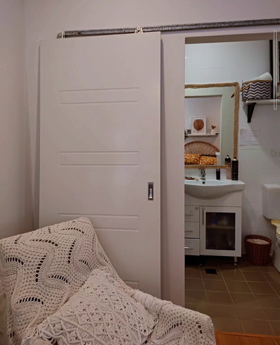

First I took the door down. Unscrewed the handles. I sanded the door lightly, and wiped it clean.

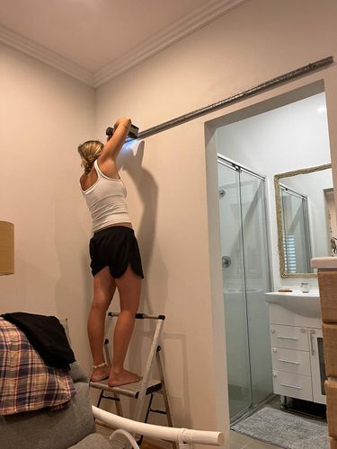

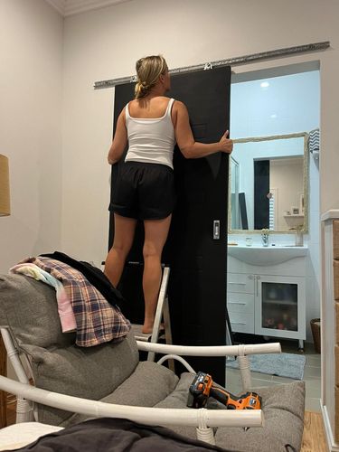

Door back to the metal track. This would have been a simple task but we had to adjust the height of the track because of our new floors. New screw holes and patch the old screw holes in the concrete wall. Then add a little bit of paint. Place the track back on and adjust the screws from the door so the door moves smoothly. I used plastic window packers underneath to adjust the hangers on top.

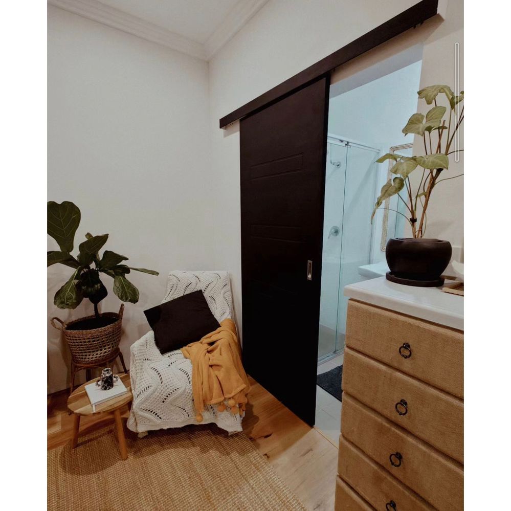

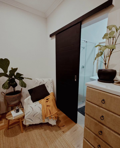

Place the cover on top. I painted it as well. And vóila you have a different look in your room.
