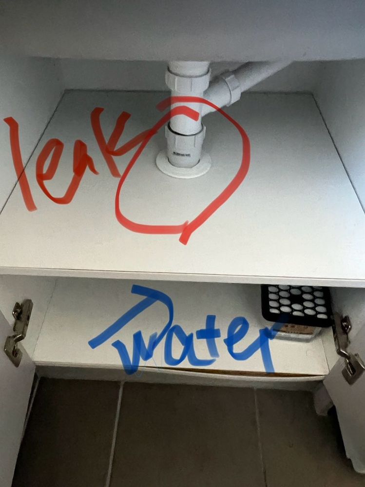

Hi all,
The photo shows what's happening, any ideas on what to do to fix this leak as it's beginning to damage the cabinet.
HI @tigerzen
Those plumbing fitttings are designed to be mainly hand tigtened see the raised lugs on the sides.
So try tighen those fittings a little more i would tighten the top connector and side y connector to as a shot gun approarch, try and nail the problem in one go.
Turn them 1 turn if they feel loose. 1/2 turn if they feel easy to move. 1,3 turn if they feel firm . 1/5 turn if feel tight. If they feel super tight and un movable open the connection up and check the washer seal is not damaged it maybe crushed.
If your hand needs a little help titghten the connevtions with a pair of adjusteble multigrips , plumber wrench, or a chain wrench be mindfull these fittings can be over tightened to a point of being damaged.
You can also us Toilet paper sheets folded dab it from the top connection or above down wards after letting the sink run for a bit to stimulate the water leak. When the TP is wet you are zeroing in on the leak to guide you to further actions .

Thanks Jewelleryrescue for that detailed reply. I have passed your suggestions onto my sister whose bathroom the post refers to. She has told me that the fittings are on very tight which leads me to believe that maybe they are damaged, I am planning to go out there to see what I can do.

It's great that you've received excellent advice from @Jewelleryrescue. Looking at the photo you posted it appears that the black O ring has twisted out and might be the cause of the leak. Just to add to the suggestions made, I recommend loosening the fitting and setting the O ring level.
Once the O ring is in the correct position slowly turn the fitting to make it tight. It's important the O ring does not peek out. The connection should come together squarely and firmly. Make sure to observe to make sure that the leak is fixed.

Thanks Eric for your input, yes I had noticed that the o-ring looks distorted. What is this pipe called, is it called a trap? If we cannot get it to sit properly can you buy a new part to replace it or must the whole pipe be replaced? If we have to get a plumber what do you think the extent of the repair might be?
Hi @tigerzen
If you look closely, you'll see the part that is attached is grey in colour not white. That part is a PVC extension piece and is usually used to bridge the gap between the "trap" and the tee piece.
The plumber could use plumber's tape to do a quick repair or remove the PVC piece and extend the waste pipe at the bottom. I suppose it all depends on what they will decide to do.
There are other parts you can use, but it will require a plumber to complete this type of work.
Thanks Eric, if the PVC extension piece is damaged in any way is that part available at Bunnings ie is it readily available?
Hi @tigerzen,
I suspect that extension piece is a Holman 50mm PVC DWV Female Iron Connector or Holman 40mm Female PVC DWV Threaded Iron Adaptor. There is no rubber Oring used in this style connector. The lower end is glued onto your pipework and the threaded top using thread tape to seal. It appears that someone has tried using an Oring to seal this fitting, which is likely the cause of the leak.
Thanks Mitchell, looking at the linked photos you could well be right, assuming it is a connector/adaptor issue what would be the fix here?
If you can see water leaking out from the threaded portion of that adaptor where the rubber seal is @tigerzen, then a plumber would be undo the connection, remove the rubber seal, apply thread tape and then do the connection back up again.
I doubt the adaptor itself has a crack or issue, but if it does, they'd need to install a new fitting by cutting the pipe underneath.
Thanks Mitchell, I'll give it a try.

Thanks to all that helped we were successful in the end. The basin was indeed leaking and we loosened then re-positioned as per Mitch's advice. The tissue idea that JewelleryRescue mentioned was great in that it helped to confirm that we had fixed the leak. Eric's advice about repositioning the nut/washer was also helpful. So, a real team effort, I couldn't have done it without you guys, thanks so much!

Something of a postscript but in the opening post is a photo which shows what looks like a crushed o-ring. It was in fact some sort of black rubber tape resembling teflon but thicker, anyone know what it is and why it was used instead of normal teflon tape?
It's likely self-fusing silicone tape, @tigerzen. It's used as a catch-all for leaks but is not the appropriate product, whereas Teflon tape is. Possibly, a home D.I.Y. attempt to seal the joint.
