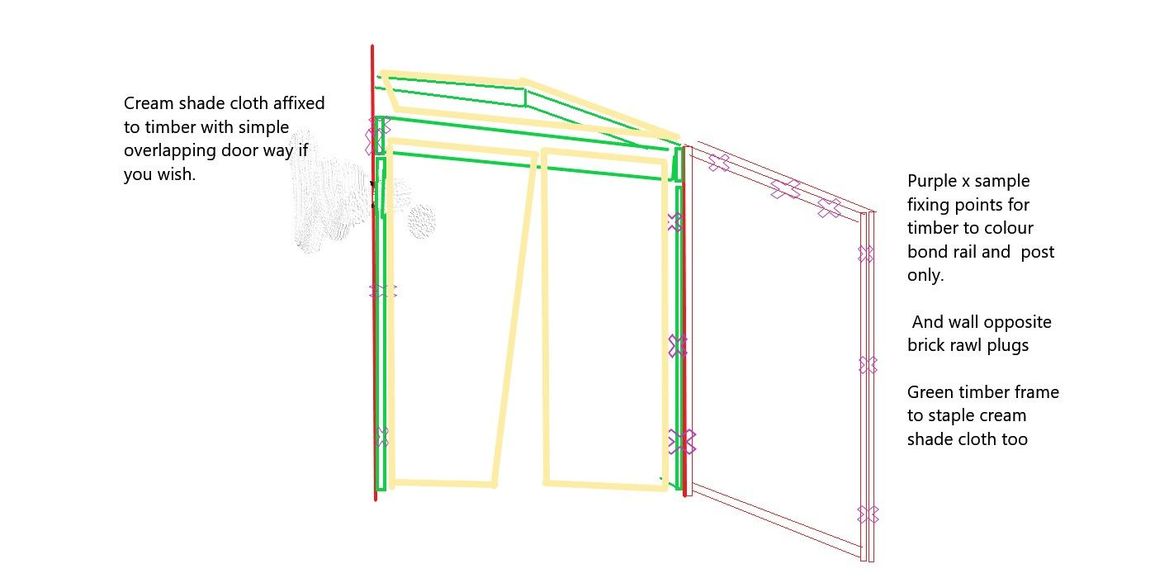

I think I am seeing want you want and the answer is timber screwed to the colorbonds top rail for horizonatal mounting point or between the top rail and bottom rail for a vertical timber mounting post for SHADE cloth. Dont screw through color bond infill panels as it will stick out on neighbours side/
On the house wall screw a timber battons and for colour bond too
