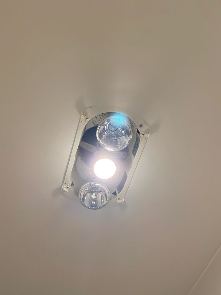

Hi All first time posting here.

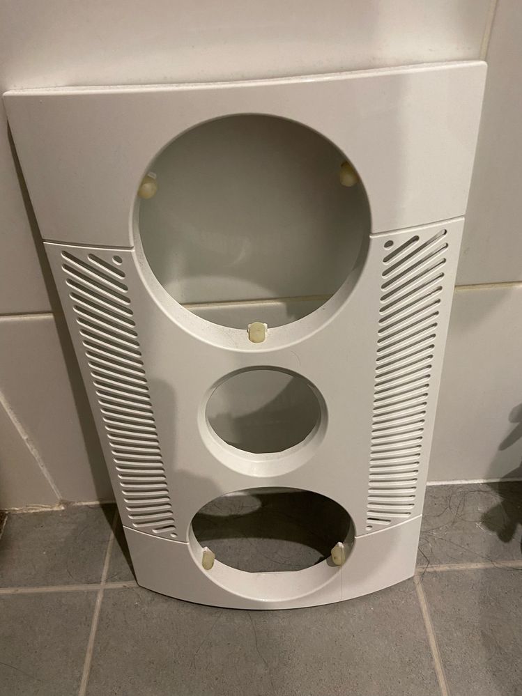

The cover is loose, keeps dropping off, any idea how prevent it from dropping off?
Thanks in advance. 😀
Hi @haoc
Do you see the roof plate with the 4 plastic mounts? I would carefully flex the outermost plastic flat bits outwards so the cover may clip better failing that I see no harm in glueing it on to the same tabs.
Chances are the heat bulbs makes the plastic soft,
As the bulbs should easy unscrew from underneath.
Hope this helps
Hello @haoc
Welcome to the Bunnings Workshop community. It's sensational to have you join us, and thanks for sharing your question about your fan cover coming loose.
It's great that you've received excellent advice from @Jewelleryrescue. Just to add to the suggestions made, I recommend observing the hooks on the cover carefully and making sure they lock into place. It's true that the plastic clips holding the cover could be soft and are letting the cover go.
To temporarily hold the cover in place, I suggest using Selleys Ezi Press 100g Wet Area Silicone Sealant on the clips and cover to join them temporarily. Use masking tape to keep the cover attached to the ceiling. Once the silicone has cured you can remove the masking tape and the cover will stay.
