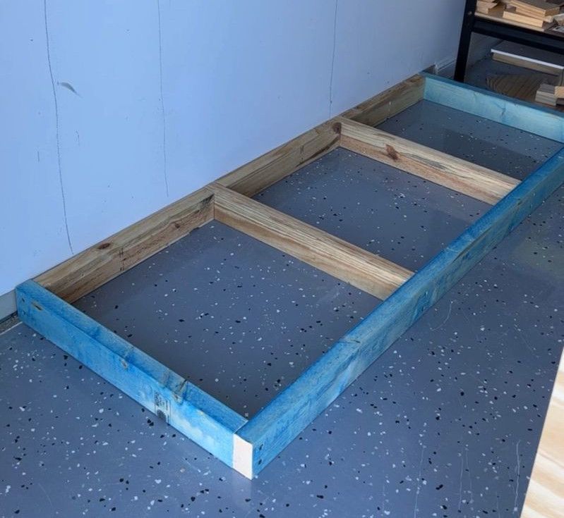

Step 2
Build base frame for the boxes to sit on and secure into the studs.

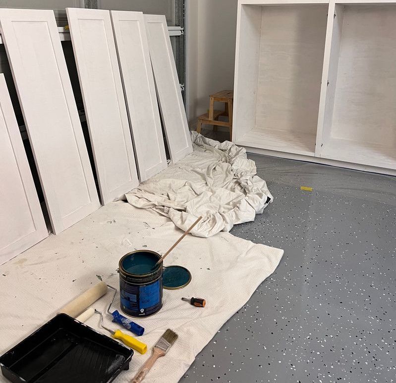

Step 8
Sand, prime and paint everything. I used a dark colour so it required a lot of coats.
