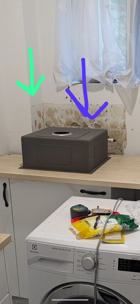

We're in the final stages of our laundry renovation and have some questions about how best to tile the backsplash.
I've removed some previously applied tiles and you can see from below the tile glue etc from where they were.
Of note is that there are two substrates we need to tile over. The property itself is brick with mortar (blue arrow) however the green arrow is a column made of MDF/particleboard.
I'm assuming for us to tile over the mortar area we need to fill the three small holes where the tip of the blue arrow is (this was from removing the previous tiles) with spackle, or do I need to fully mortar those holes?
For the MDF area you can see where removing the previous tiles has ripped off the paint and exposed the MDF substrate itself. Am I going to be OK to prime and paint this area so the tile adhesive is not going to go into the MDF itself?
Any additional advice is appreciated.
