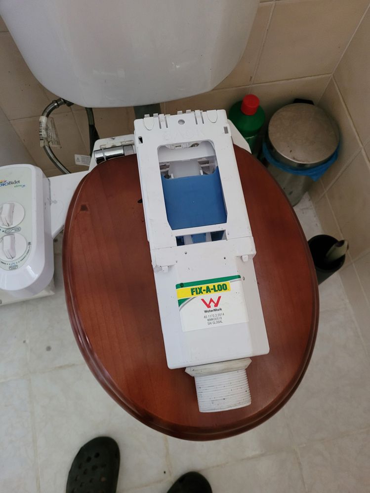

I need to know where does the seals fit on big nuts, the tapped seal
fit on cistern on the inside of the cistern is that correct.
thank you
Seeralan
Welcome to the Bunnings Workshop community @seeralanmoodley. It's amazing to have you join us, and many thanks for your question about installing an outlet valve.
Here's a copy of your instructions. The wedge washer fits inside the cistern. Place the outlet valve and wedge washer within the toilet, and screw on your nut from underneath the cistern.
Please let me know if you have any questions.Mitchell
