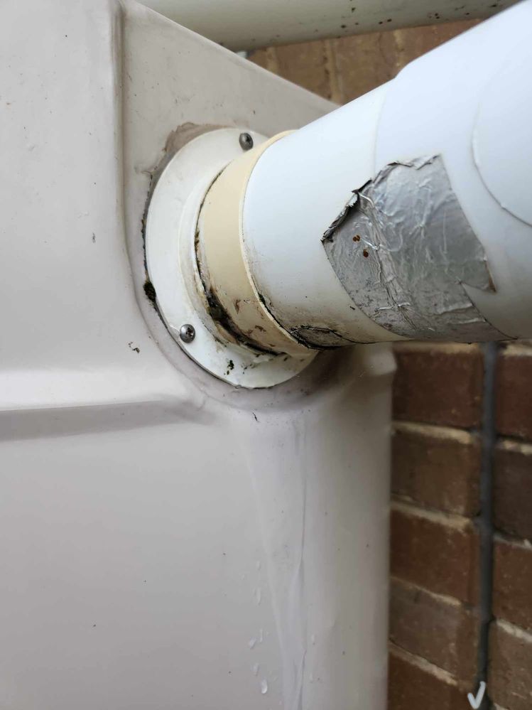

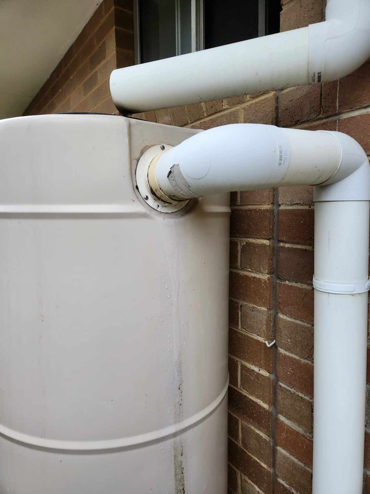

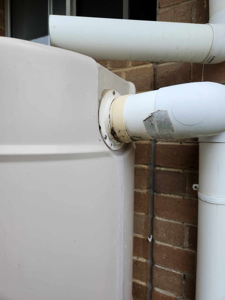

I've noticed the overflow pipe for my rainwater tank leaks when it's full. Just wondering how easy this would be to fix myself and what sorta tools I would need. Appreciate any advice.

First you need to check if the overflow pipe are loose. Grab a hold of the pipes and see if they can be disconnected from the tank. If they can, odds are the adhesives holding them in place have deteriorated. In order to fix it all the parts must be removed the edges sanded clean and new adhesive put in.
I suggest using Protek 125ml Type N Blue Cement Solvent to join the pipes back together again and to attach the overflow branch to the tank. Make sure that all the pipe work is clean and free of moss mould and debris.
Before fixing it in place, I suggest doing a test fitting to make sure everything is where it's supposed to be. Once you are confident that there are no broken pieces, you then apply the glue to once piece at a time fix everything into place.
Once its all organized you can slowly re-assemble the downpipe with glue.

The pipes don't seem to be loose which is good.
I was wondering if it would be better to replace the entire overflow pipe. Would something like this work? If so, do they come with a gasket or is that a separate item?

I think @EricL is on the money here. The part must either be pulled apart or cut out and replaced with glue on the joints.
Regarding replacing the overflow pipe, were you intending on having just that short fitting and the water being dropped directly onto the ground?

No I was thinking of replacing the overflow pipe (As I noticed cracks on it around the screws) and connecting it to the existing downpipe.

You will need replacment tank outlet fittings avaliable at bunnings with a tube of silicone to seal it to the tank during replacment simple matter to unscrew the tank fitting and clean surrounds, But water may gush out can you pre drain the tank level below the out let level ?
But if you are not confident with plastic plumbing fittings I would suggest external siliconing the cracks up and the use of duct tape as a repair.
Not hard to do but still not super easy for a new learner project.
My apologies for the late reply. The Rain Harvesting 90mm Extra High Flanged Tank Overflow can be used for your tank however, it will require a bit of rearranging how your overflow is set up. The issue is that the fitting has a 90-degree bend in it which means that it will need to be reconfigured in order for it to work.
Another option is the use of the Rain Harvesting 90mm Flanged Tank Overflow which is a straight connector. This means that the old fittings on the tank can be removed and replaced with a straight pipe for a fresh new connection. Please note that the fitting is reversable so make sure that it is facing the right way when being installed.
If you have any other questions we can help with, please let me know.
