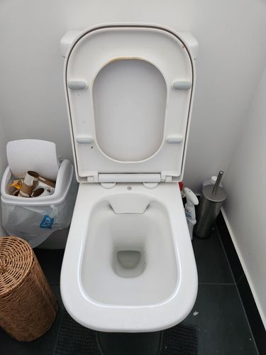

Some soft close units come with the hinges independent of the seat others are moulded into the seat itself. Would it be possible for you to post a photo of the entire seat and a clear shot of the hinge assembly. This will allow me to make recommendations on what toilet seat to replace it with.
If you decide to visit the store, I suggest measuring the length and width of the seat along with the distance of the mounting holes. These measurements will come in handy when you look at possible replacement sets.

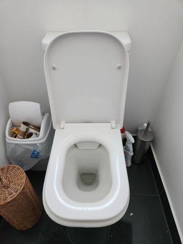

Please see attached photos of the toilet seat cover.
To be honest I don't know where the hinges are.
Please advise thanks.

Hi @algenebautista,
I'm sorry, but it appears your hinges are moulded into the seat, and I can't imagine there is anything adjustable there. It's likely that the soft-close mechanism has failed, requiring replacement.

Yes, it would be the whole toilet seat. I had a similar issue with a soft-close toilet seat a while back. I accidentally pushed it close, and it broke the hinge system. The seat needed to be replaced as I couldn't access any relevant parts in the hinge system. You can pick up very budget-friendly soft-close seats these days, like the Estilo White Quick Release Soft Close Toilet Seat.

No, @algenebautista. The ceramic cistern and pan (bowl) stay, and the plastic seat section gets removed and replaced. There will be some hidden fixing method to detach the seat from the pan. If you can take some pictures from the side and directly above the hinge section, we might be able to point out how to remove it.
